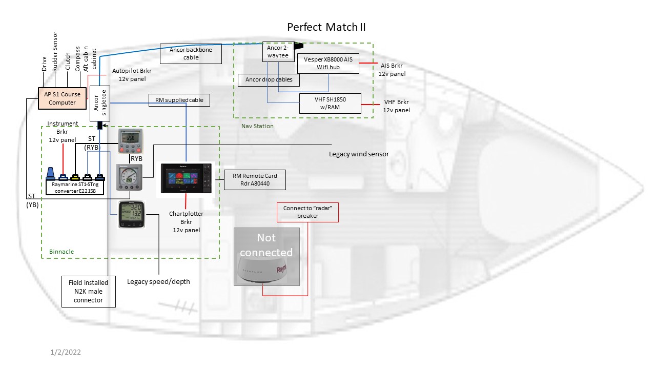

4B5F8491-5853-4616-BB6E-1F16C4D2D7F5.jpegI made this change a couple of years ago. It took longer to research and gather the right equipment than it did to install. Of course, that’s the point I suppose. I kept all my legacy equipment except the tri data. The screen was shot and I couldn’t repair it, although I did replace the screen on my st6000 control head. I added other n2k devices, but if you aren’t then everything is right there in the pedestal and the aft cabin. Also, there are circumstances you would need to use the itc5 but in some cases the nmea converter is sufficient. As mentioned, your analog radar won’t work with a new digital mfd. I’ve got a perfectly good analog radar unit along for the ride until I can get around to replacing it. Happy to discuss if you have questions.
Tim
