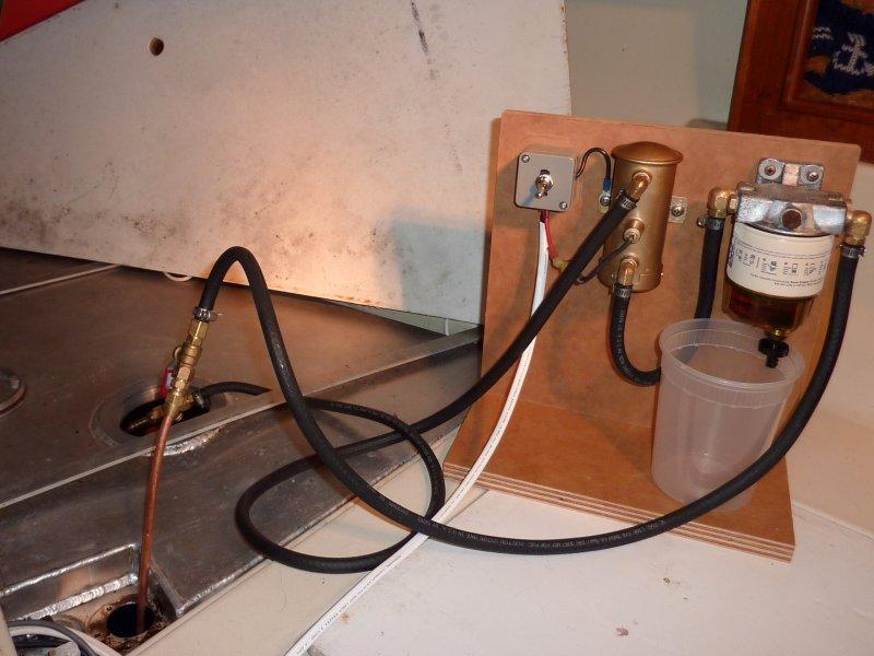

This is what I use to suck small tanks dry and get the water out of them. The copper tube is jammed all the way to the dead bottom of the tank and gets all but about 3/4 of an ounce. The last bit is removed with a microfiber rag on a stick. Not fast but works well.

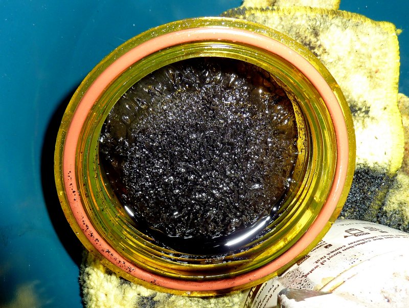

You never know just what you'll find in there...
This was 25+ years of accumulated water and crud off the bottom of the tank..
And why the engine ran like crap..
