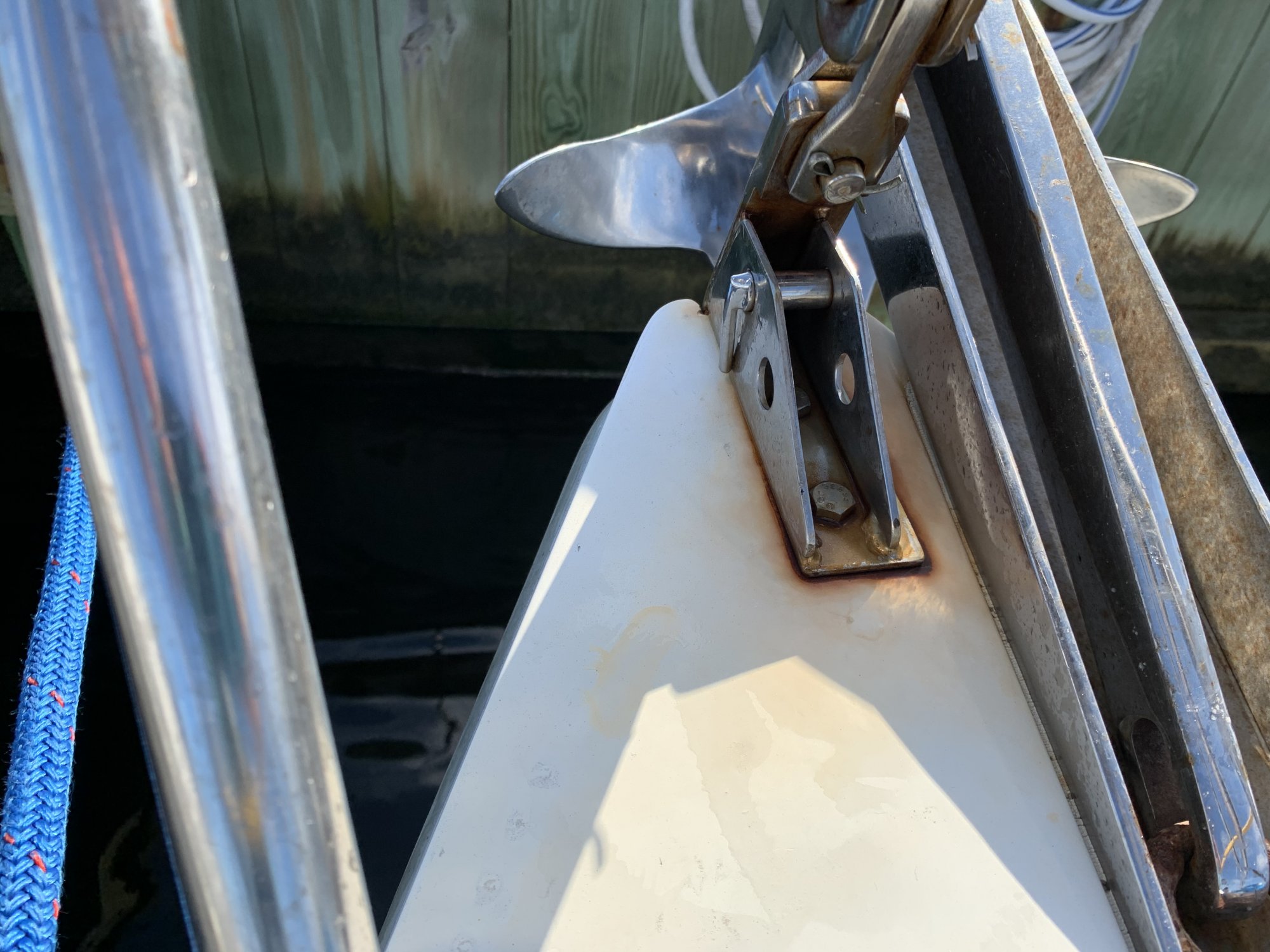

I've been most alarmed with the stem fitting on my new 1999 Catalina 320. I have a picture of the stem when I purchased the boat in June that shows no rust stains whatever around the stem fitting. Now I have this.
As it turns out, the original stem fitting on the 320 is a known problem. CD sells a modified / simplified / and more robust fitting. My plan is to replace the fitting as my first major project. I suppose that I could tie off the halyards and replace this with the mast standing. However, being cautious, and curious about other fittings on the mast, I think I will take the mast down. I may even think about replacing all the 20-year old standing rigging.
Now I need to find out how to gain access to the fasteners inside the hull!
I read in the Catalina forums that this particular fitting is prone to crevice corrosion because of the wings welded to the sides. The new fitting is entirely made with steel at the thickness at the toggle bolt. The wings are eliminated and there are no welds.
Does this look alarming? Should I be ending my season early? It looks alarming to me.

In the anchor locker (on the 270 at least) there is an access hatch at the very front where you can get to the nuts. Having replaced this part, Ill offer that whatever you put through that hole to act as a wrench/ratchet, Whatever, is firmly attached. And you use some wax or goo on the nuts and washers when reinstalling to keep them in the socket until attached. You’ll never see them again otherwise. Dont ask me how i know this. :)

That is pretty shocking rust. Good luck. Meriachee has some good advice there.

The amount of rust is concerning so your plan to replace and inspect during the off season sounds good. However, even if the welds failed on your headstay I wouldn't be too concerned. The main load is on the strap which is a continuous piece and not cracked so the welds may break but your headstay will not fail.
As to mast up or down, just run a halyard (or 2) forward and tie those off. They will support the rig while you replace the fitting.

It looks like the rust might be running down from the furler with some staining on the toggle, the shackle below, on the deck behind the stem, then obviously down the bow.
Any changes to the furler or headsail that might introduce the problem, maybe a bad shackle, seizing wire or something?
The season is ending in a month or so, if it were my dilemma I'd clean up the rust (maybe some barkeepers friend powder?), examine it closely with a magnifying glass for visible cracks, then go sailing. I always run the spinnaker halyard forward of the furler and attached to the bow pulpit as a backup to the headstay, that may give you some peace of mind until hauling.

Might be good to check that whole fitting with a magnet. If mildly magnetic, the builder received a run of SS that did not meet specs. Excellent Idea to remove it, buff it to a mirror shine, and check for cracks on all sides, with a magnifier.

Scott the previous owner had cleaned and dressed the boat for your review and purchase.
Now you find something needs your attention. Your idea to nspect not just wave it of with some cleaning makes sense. Somewhere there is some iron rusting.
Look to the fore shroud and follow it up till you find the source.
What type of furler do you have. I had a ProFurler. It used steel ball bearings captured in a sealed case. The seals crack and the bearings are able to see moisture and they rust.
Only by inspection can you resolve this issue.

The majority might well be coming from the furler, down the back and sides of the tang, and migrating through the bolt shafts, in fact making it look worse than it is. Look at the sides where it passes through the deck.
With the possible exception of that blob beside the second bolt down. If that's not a puddle that dried, there's maybe bigger problems here.

Ahoy, Andante, from SV Andante! The bow strap (chainplate?) on my 2003 C310 doesn't show any rust yet. The one on your boat, unfortunately, looks to be made from a lesser grade of stainless steel. The large amount of rust built up at the base of the strap seems to indicate the rust is coming from the back of the part. Let us know what you find.

No. It's only 4 weeks or so. And even if a bolt is failing you have 4 others.
It looks to me like the lowest (Closest to the waterline) bolt is responsible for most of the stain. I'm guessing the bolt, nuts or washers are of inferior SS. The rest of the rust I think you could find on many salt water vessels if the SS wasn't cleaned and polished. Contrary to what we are told SS needs maintenance.
