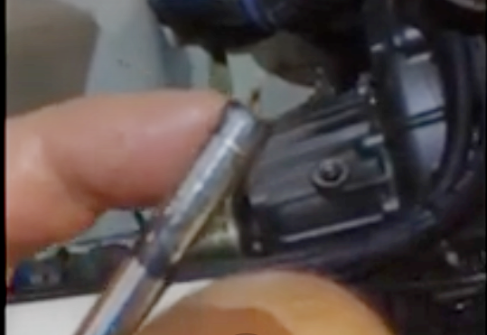

Didn't watch it all but this guy was not too clear on the fill mark :
He shows the end of the dip stick but the fill level is that first groove about 1/4" from the end of the tube.

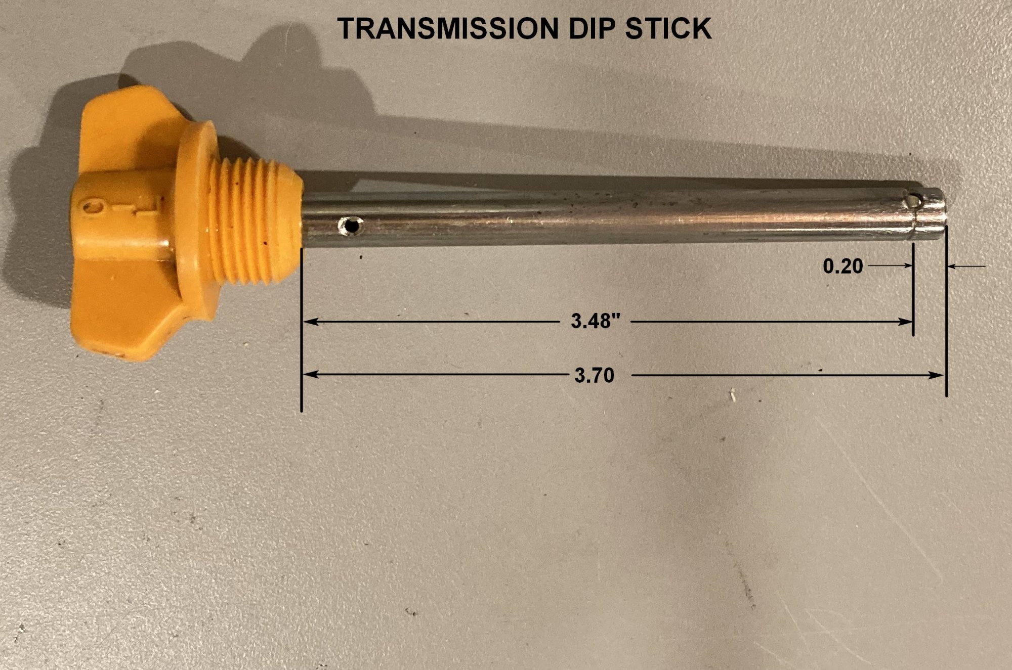

This is a better shot of the KM2P dip stick showing that groove at 0.20" :
................. which is the same for the 2GM.

So, the oil level (in transmission) should be within the .20" on the dipstick (below the mark), correct? And I shouldn't screw the dipstick to get the reading (like what the guy said in the video)?
Yes, that’s correct.
