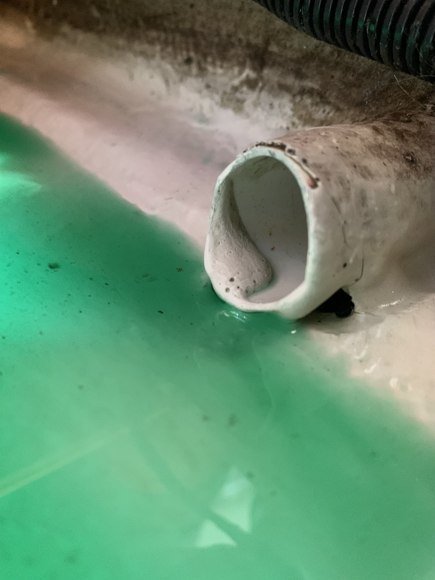

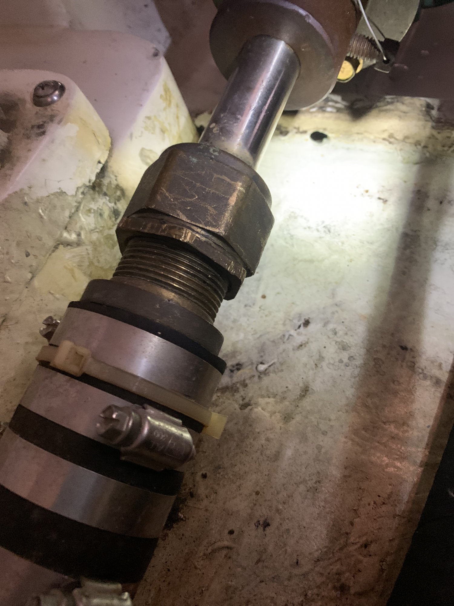

Update - Upon closer inspection...there is a drain hole for packing gland dripping and it drains to the main bilge compartment BUT very difficult to see (re : pics).
In this pic you see the mold for the drain line underneath the engine :
You can see the drain hole in this one :
Its at the base of the small bulkhead that separates the under engine drain pan
Packing gland drippings drain into the main bilge compartment BUT from the bow end NOT the stern end where its draining from.
The drain hole is a small slit underneath the drain overflow pipe into the other compartments
Using green food coloring I discovered it was my packing gland leaking way too much...1 drip every 3 to 4 seconds doesn't sound or look like much but when you do the math of over a 2 week or 3 week period...it adds up to 20 to 30 gallons.
Anyways...mystery solved and I discovered there is a drain from packing gland to main bilge on the old C320s.

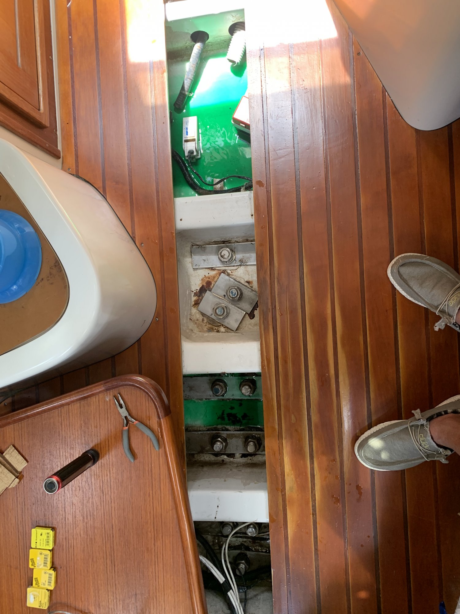

Great find! If I'm not mistaken, the packing gland shouldn't be dripping when the shaft isn't turning. I'm also curious, where are your keel bolts? Is this a bilge compartment forward or behind the keel bolts? My model is 1999 so it has a deeper bilge, but it is so narrow and filled with keel bolts that there isn't even room for a submersible bilge pump. There is barely room for the hose pick-ups and a float valve.
Jul 31, 2013
7
Catalina 320 Lake Lanier
You can see my keel bolts in the last attachment...they are distributed across three individual bilge compartments. One is too shallow and nothing drains into it the other keel bolts you can see in the pic...
Does this answer your question?
