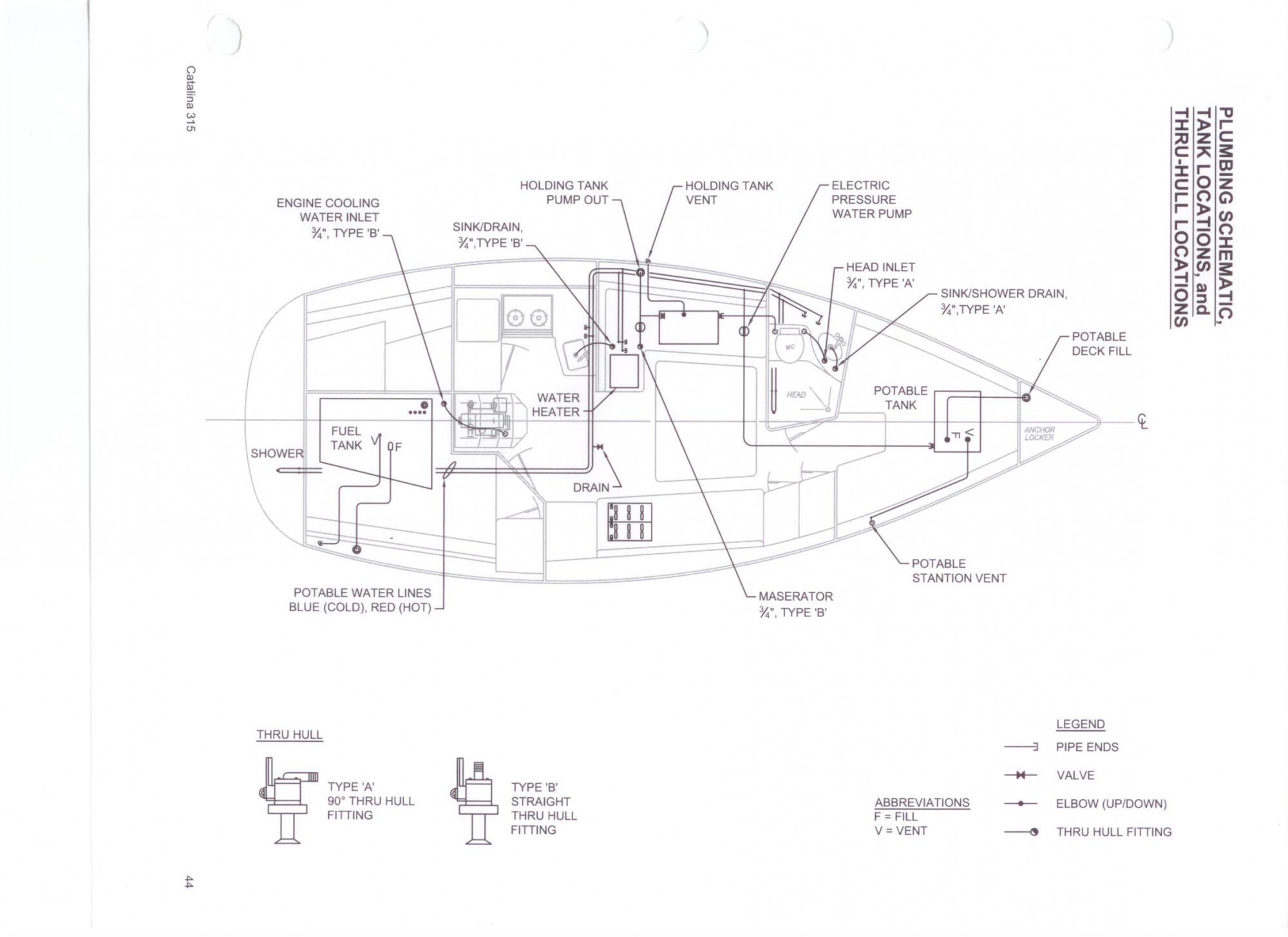

And I have a couple of other questions that you might be able to answer Stephen...if we can’t coax other 315 owners into this thread. First, does the shower drain have its own pump and thru hull? Are the freshwater tank and pump under the forward berth? Has anyone located reasonably priced fitted sheets for the forward berth? Finally, I’ve been told by a broker that later versions of the 315 have a double anchor bow roller and stern rails that run right up to the entry gate on both sides. Is that true?

It is snowy here today in Grosse Pointe, so I am answering you from memory and my handy owner's manual.
-The shower drain does have a seperate drain pump and switch in the head to activate it. The plumbing diagram does show a thru-hull under the head attached to it.
-The diagram also shows that the tank is under the forward berth. But the freshwater pump is just aft of the head.

Thanks Stephen. Very helpful information and drawing. I have tried to find the 315 owners manual online without success. We had brief access to a 2018 boat last weekend but as far as I know it’s the only one on Vancouver Island
