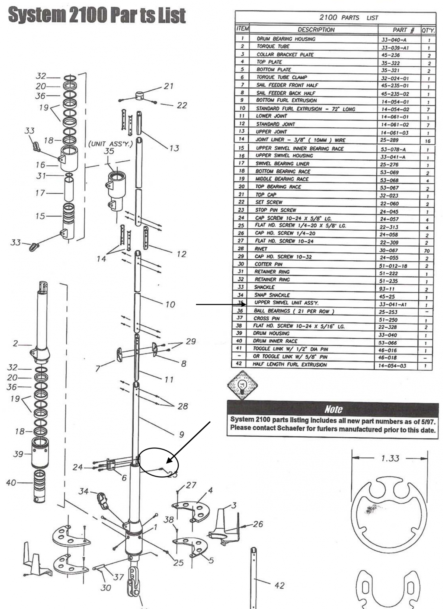

When I took it apart to adjust the head stay, I think, (but am not sure) that the bottom furl extrusion lowered down, and is blocking the stop pin from going back in? I have tried everything, but not sure what to do?
Ideas?

Thanks Buddybear, I will give that shot, though not sure how to get the line tied to the extrusion and up inside to be able to pull it out....
Attached is the diagram with an arrow to stop pin that is blocked from going in.
