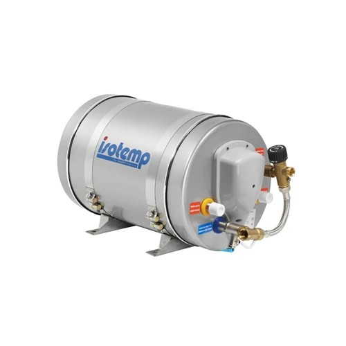

I would vote for an Isotherm SPA. They come in various sizes (from 15 l (4 gal) to 40 l (11 gal)). They are not the cheapest, but very good quality. I have installed the small one (15 l), but my boat is substantially, smaller. I suggest, you get one with a mixing thermostatic valve.
Following advice from this forum (I think it was Maine Sail), I used SS braided connectors for attaching to the water system (this water can get hot).
Installing is generally simple.
Check your dimensions to make sure you can put it in.

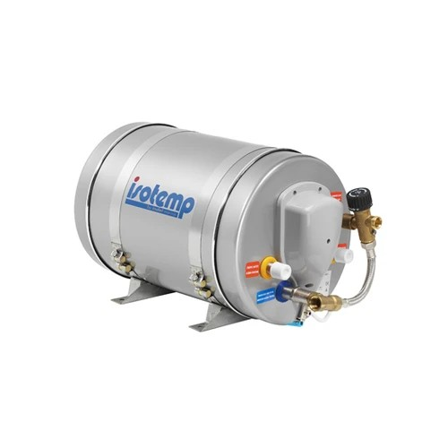

We just replaced our water heater in our 1999 hull #1 but it never leaked. Instead the fuel tank leaked and if you have to replace the fuel tank you have to remove the water heater so makes sense to replace that too. Went with an Indel 6.4 gallon SS heater and like it very much. Much smaller than the original 20 gallon heater so there is a lot more storage space in the starboard locker. Plus the new heater blends cold water into the hot water so you can control the temp coming out which is a big help. Don't think we will run out of hot water due to that feature.

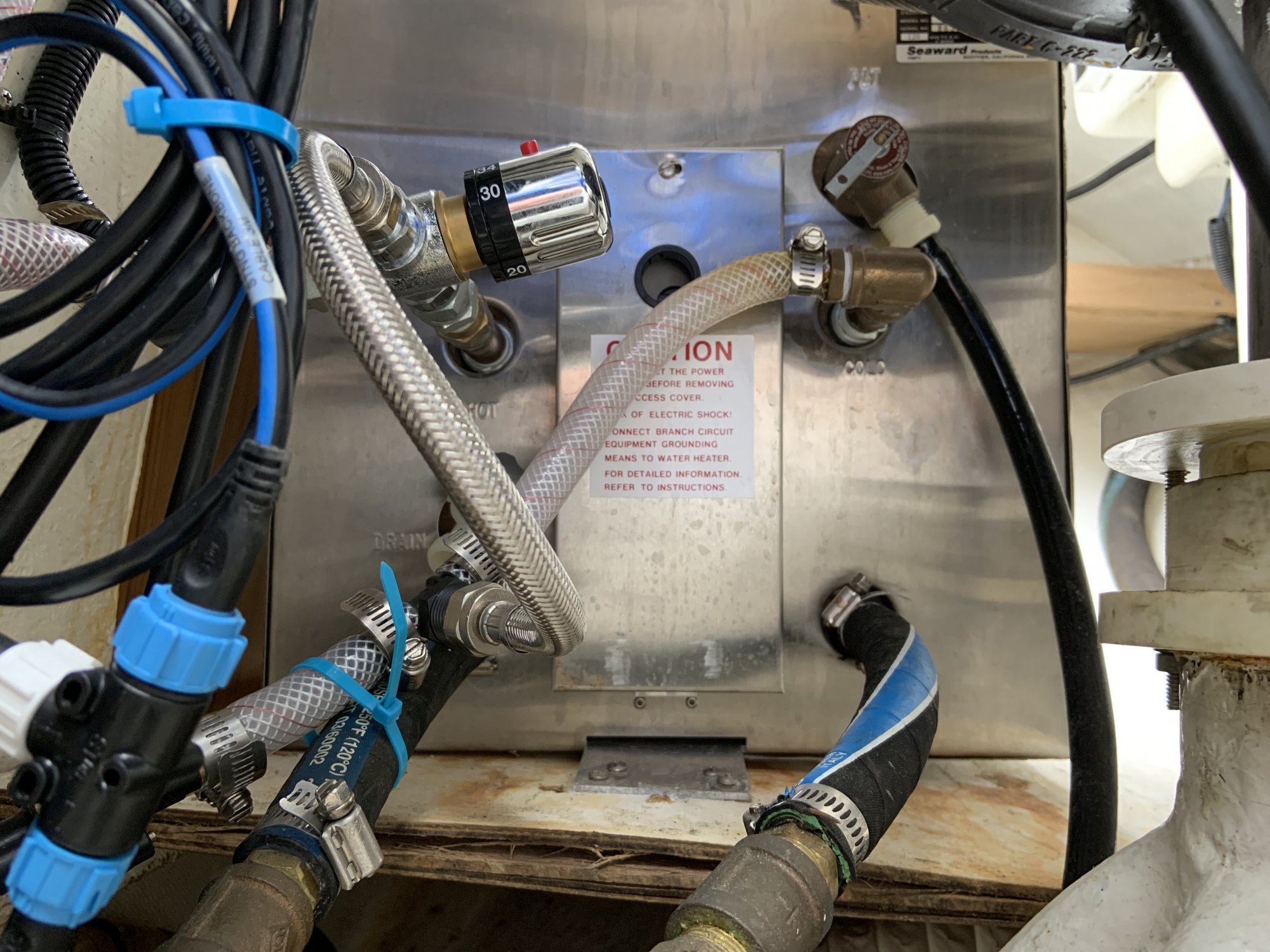

Just a quick note that you can easily add a mixing valve to an existing water heater. It's nice that they include it installed on the new unit.
Here's the one I did. Pretty sure I bought it on Amazon.

That's the "tempuring valve" with the black handle-knob. IN Post 13, it is the chromed knob.
