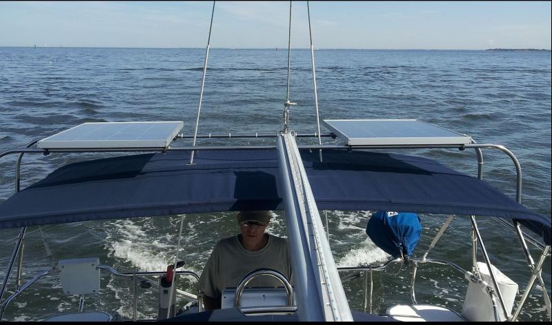

I purchased two Solarland 85W solar panels from eMarine Systems, complete with controller, wiring, fuses, and a very useful remote display. The total cost was $890.85. I mounted them over the bimini, making sure they did not hit the boom; they fit perfectly. I purchased mounting hardware from Marine Depot, Sailrite, etc., and I used Sea Dog Oval Plate Bracket Kits (327101-1) to attach the panels to the 1” stainless tubing. Unless there was more than two days without sun, I was completely energy independent.

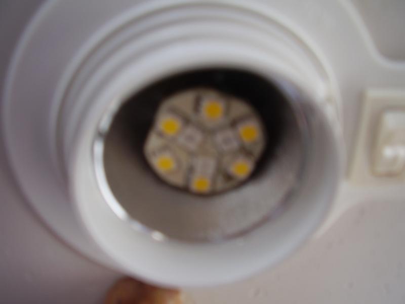

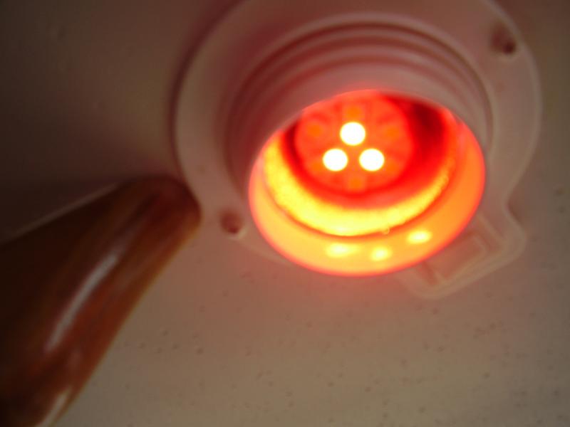

Except for the lights in the head, I replaced all bulbs with LED’s including the anchor light. For the anchor light I used Dr. LED GE 90 STAR (H2492 Star) in the original Hella fixture. Although Hella vigorously recommends against this replacement, I have had no problems and it was one on the brightest lights in the anchorages.

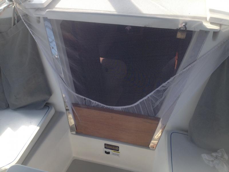

One cheap, low tech, but very valuable addition was a “screen” for the companionway. I purchased a net used for baby carriages, stretched it over the winches and held it down by folding it under the lower washboard. Perfect!
