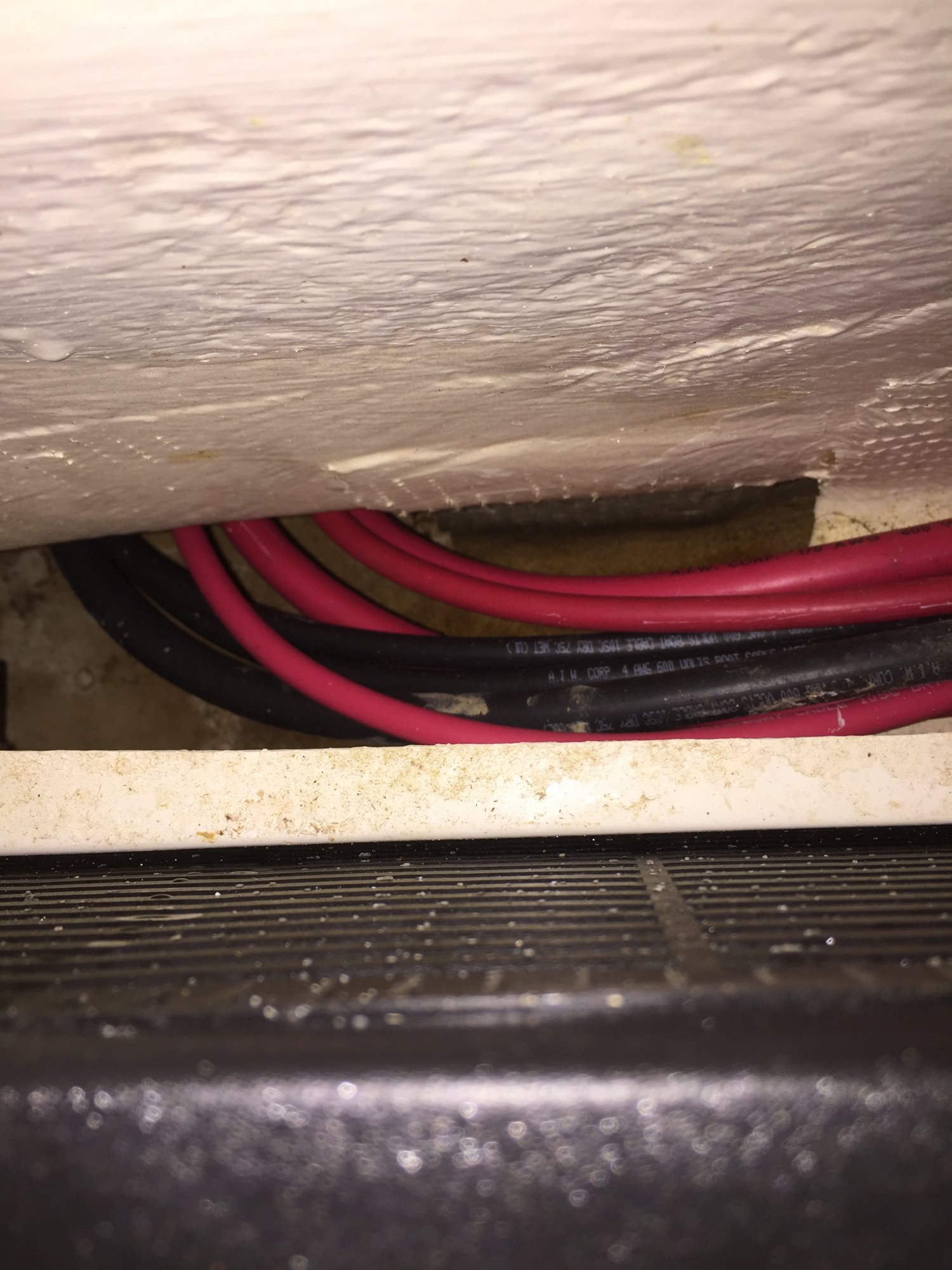

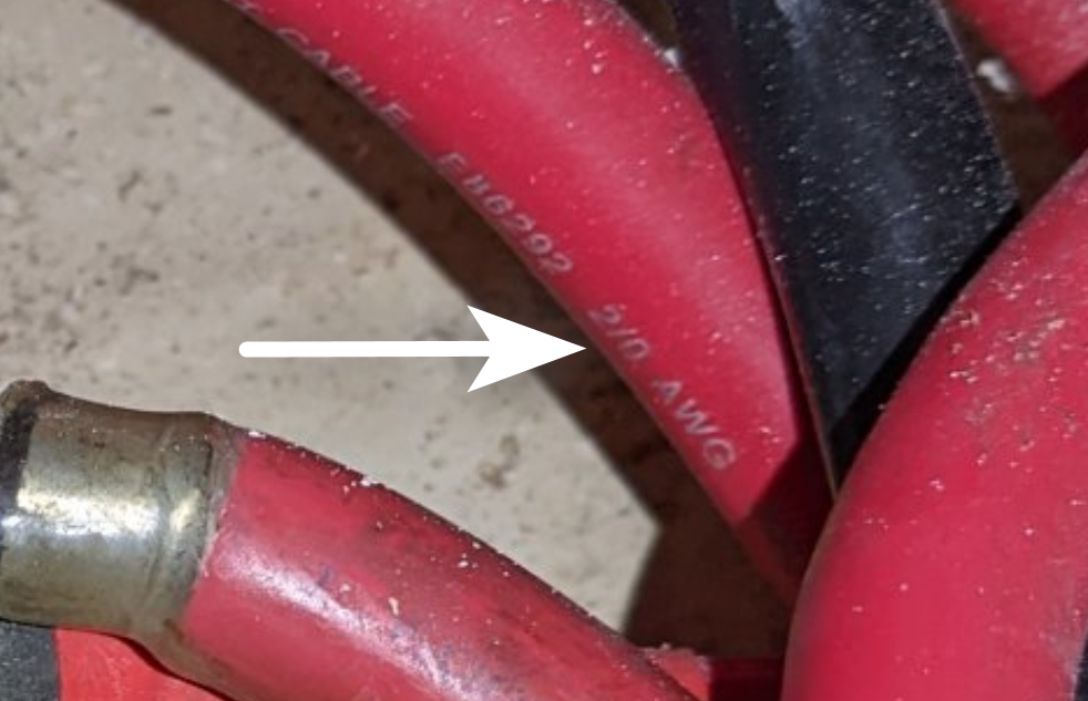

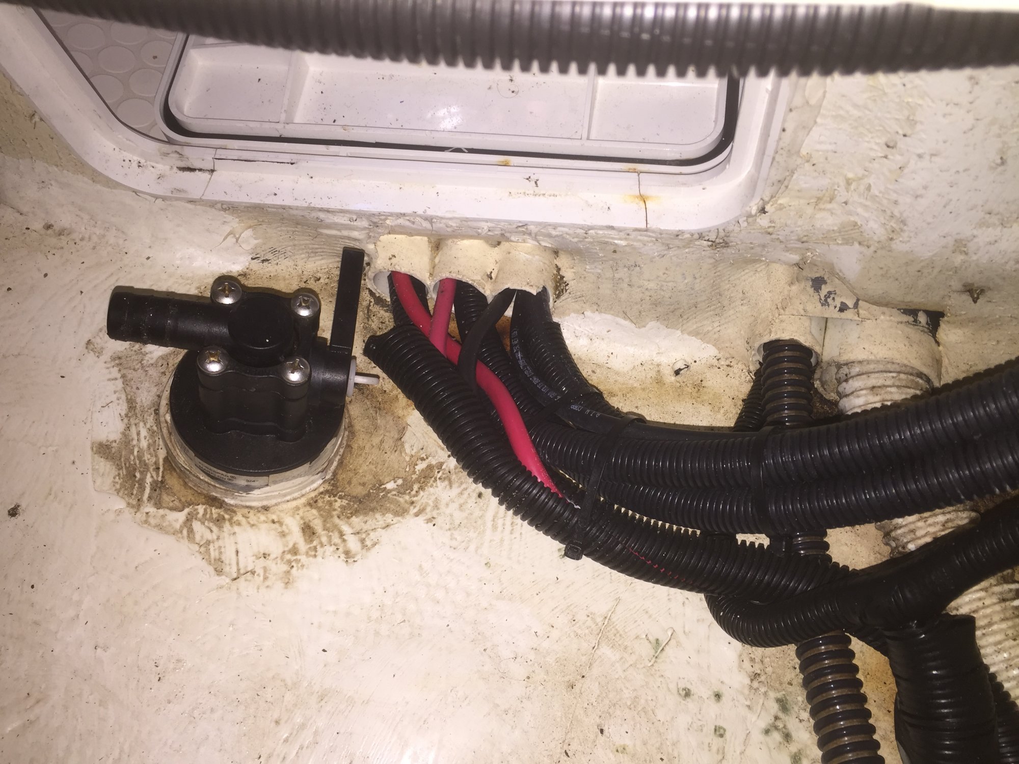

Catalina 310, 2000, #31 31 Santa Cruz
I’m assuming your C310 looks similar to ours (hull #31). Here’s pictures of each side of the wire conduit. I rewired using size 1/0, 2, and 4. It was pretty easy to get all of them through and up to the batteries. In hindsight I should have run all of the negatives to a buss aft of the conduit and had just a single, larger negative to the batteries. It’s on my to do list.
