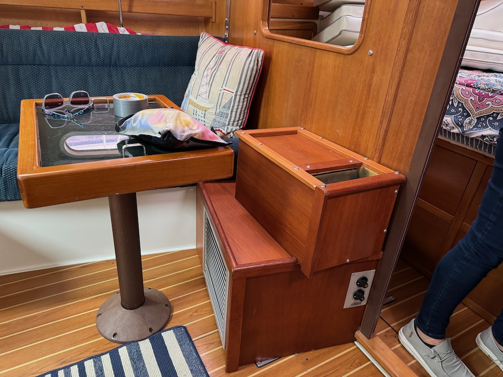

I am thinking about making an offer on a Catalina 310. I like everything about the boat except for the air conditioner placement. The unit is mounted in the forward part of the salon underneath the table. There only appears to be one air duct that exhausts directly above the box holding the unit. I am guessing that that this is some sort of aftermarket add on. Has anyone seen this setup before and if so, how well does it work?

Hard to tell how well it worked since it was pretty cold outside. That said, I’m not sure much cold air would reach the aft cabin. Where are the units normally mounted on the 310s?

Would like to see a picture because I cannot visualize the installation you describe. My AC is in the most forward part of the V-berth and have heard of the port cockpit locker as another possible location.
Do you have any pictures of your installation that you can share?

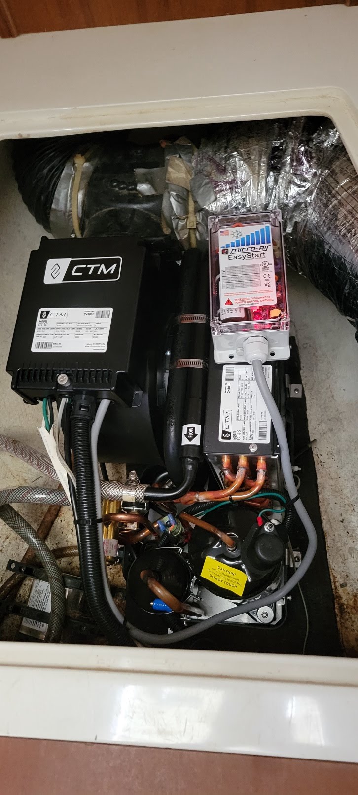

Here's an article published in Mainsheet quite a while back of a 310 installation. Mine is in the stern port locker with intake in the stern bunk and vents in the stern berth aft wall starboard, the head, and the main saloon through the small storage locker on the port side. vent in the V-berth which I wish I had, but it works well.
Here is a shot of the A/C installation:
D
Deleted member 117556
Thanks for the photo. Seems like a waste of valuable space in the salon which is already undersized. But as long as it works...
