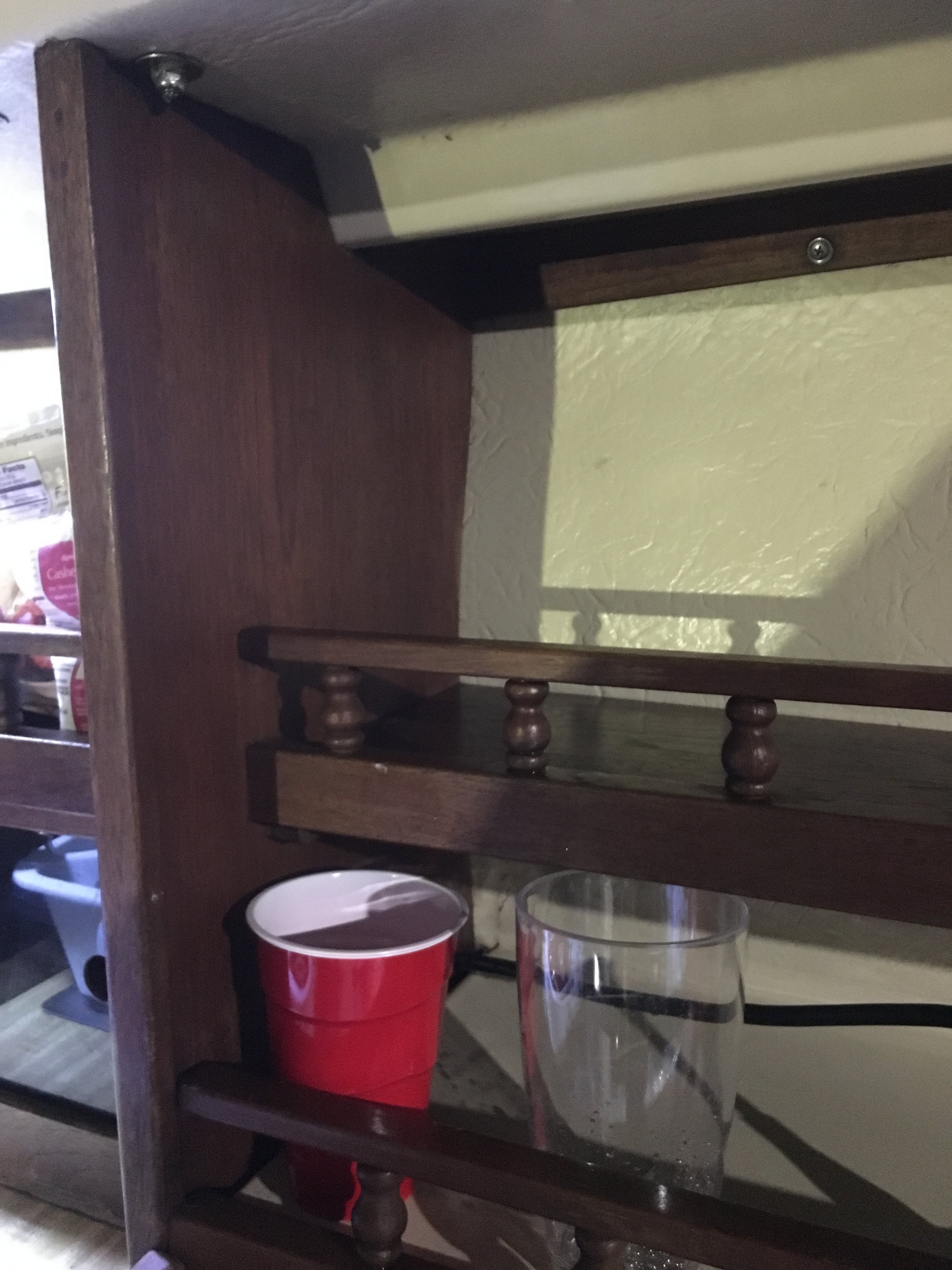

I found quite the leak coming from the hole that feeds the 12v wires for the light above the ice box. The hole goes through the thing that looks like a "gutter" on both sides to bring the 12v wires through for the light. Does this "gutter" have a name? The boat is nose up a bit so it could be water running along this gutter all the way to the low point and coming out this hole. So frustrating to track down. It is wood stained water as well. Thanks for the info!

Here's a picture showing the "gutter" in case it's not clear.

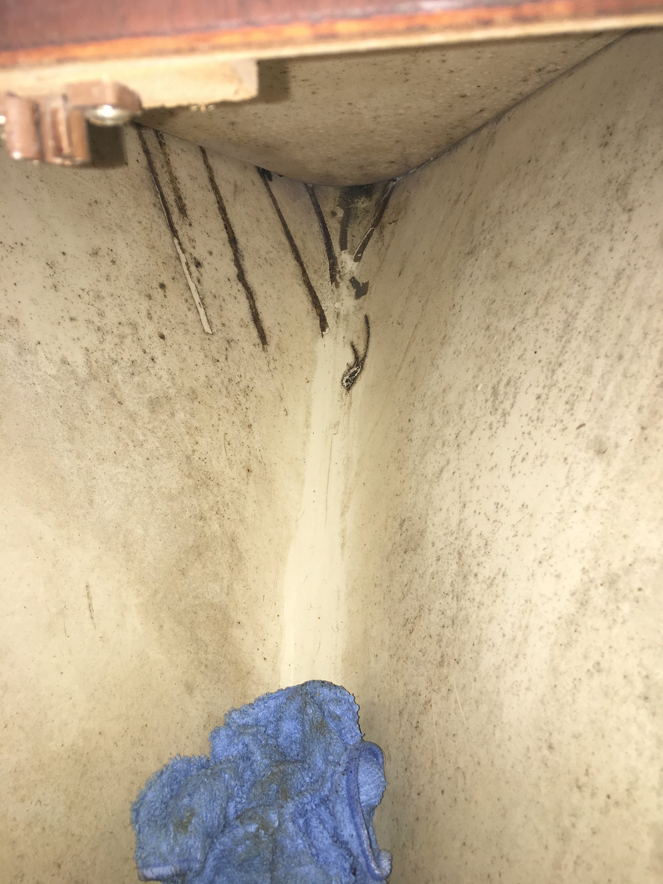

I'm attaching a photo of the bow locker in the vberth as I have a leak coming from the top corner or the tip of the bow. Would you think this is from a looses chainplate or anchor roller? I tightened up the screws on the anchor roller a little bit in the rain trying for a quick fix to stop the bleeding. Didn't help much. The anchor locker is dry. Any ideas?

For any interested, here's what I found on an '82 C30.
The anchor locker drain has a small metal thru hull pipe to drain the locker through the bow. That pipe seems to have deteriorated at the edges so water was making its way down the hull, into the vberth front locker and then run across the berth until it reached the hatch and dripped onto the water tank...eventually along the floor of the head and down to the bilge.
I'm working on a solution to refit the drain.
