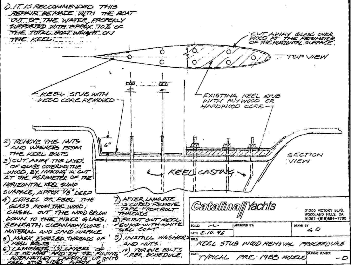

For a non Catalina owner, could you gentlemen please explain the function of the plywood spacer between the fiberglass stub and the lead keel ? I'm only presuming a lead keel here. Thanks.

The keel on all C30's [and other bolted on keels on Catlina boats] are lead. The keel is cast with bolts [mild steel on older boats and stainless steel on newer boats. The keel is bolted to a stub keel that is fiberglass and projects down from the bottom of the hull so that the keel stub joint is 6" - 12" below the bottom of the hull. This is different than the way that Beneteau and many other European boat manufacturers attach their keels.
In the C30 and I assume other Catalinas before sometime in the late 1980's, the bottom of the stub keel was fiberglass, two layers of 1/2" plywood bedded into thickened poly resin. It is then covered over with several layers of glass. This makes a very strong composite base to the stump with good stiffness because the whole thing ends up about 1½" thick. As long as no water ever gets into it, there is no problem.
The problems usually begin with owners who do not understand this and deside to install a nice big automatic bilge pump and mount it by screwing the pump to the bottom of the sump. The screws then leak and water gets into the wood with the result of the wood turning to mush.
Fine, good, as far as it goes. But WHY ? Because the bottom of the stub is rough and irregular ? Is this a remedy for creating a smooth surface to bolt the top of the smooth lead keel against. Just off the top of my head, why not make a 1" thick plate out of fiberglass rather than plywood and avoid the danger of water ingress ?
Do you know how the keels are attached on a new Catalina hull today ? The net is loaded with the problems of Catalinas with plywood spacer disintegration.
They did it because it made a strong and stiff attachment for the keel and will last indefinitely as long as the owner doesn't pock hole in it which will allow water to get in. There is no doubt that there are many posts about repairing the keel but I dare say that the percentage is relatively small compared to the more than 6,000 C30's built.
They used a lot of plywood in the construction of the early Catalina's and frankly I don't think anyone really expected them to still be around this long. I recently saw a yachtworld post for C30 hull #1 and she still looked great and was ready to sail. That boat was made in 1975 so it is now 48-years old. My 1988 still has the plywood in the stub because I have maintained the stub to keep water out of the plywood. I have also advised a guy with a 1984 on how to rebuilt his stub that had a rotten core and he did the work for about $500 in materials. Much cheeper than a new 30-footer.
That said, Catalina found that the plywood was causing problems and removed it in leu of more layers of cloth to build the stiffness beginning in late 1988.
BTW, how many Hunters, Bene's, and others have you seen that have structural grid separation or hull delamination from cored hulls below the waterline.
Can't really see how adding a layer of anything between the stub and keel adds anything to the final assembly but so be it. I do know from my research that the Hunter (for I don't know how many years) has only a finished surface on both the stub and the keel which are butted together with 5200 between for sealing the keel bolts.
That's something I'd rather not know as I have enough sleepless nights with my own boat problems.
You have a misunderstanding of the plywood in the Catalina keel stubs. It is not a layer of plywood between the keel stub and the keel. It is a sandwich composite inside the stub. The hull mold has the stub integrated into it. The bottom mating surface of the stub is aproximatly 5/8" thick of solid glass that is perfectly flat and smooth as is the top of the lead keel. The plywood is bedded into the inside surface of the stub with Mung (resin mixed with loose chopped strand fibers) which fills the irregularities in the interior surface of the stub layup. Then another layer of plywood is bonded to the first. This is then covered with several layers of cloth that go over the plywood and wrap up the inside surface of the stub. This way the plywood is fully encapsulated and makes up a 1½" composite structure that has the same strength and stiffness of more than an inch of solid laminate.
The keel which is solid lead as opposed to cast iron on many of the Hunter and Beneteau boats, is bolted to the bottom of the stub with 5200 and SS keel bolts. Here is the repair procedure that Catalina came up with to modify the older boats with the plywood composite to solid glass like was done in the later boats.
Thanks Hayden, at last a picture, thousand words, etc you know the old saying.
Now that I see how it WAS done, my only question once again is WHY ? Why cheap out and build up with plywood when heavy FG cloth is so much stronger and no worry about anyone punching a screw into the wood.
I've never been able to find anything on how they treat their keel assemblies now but I can guess it's the same as this repair job is done without plywood but before the keel bolts are installed to get in the way.

I do not know about the new boats but to the best of my knowledge Catalina has modified this detail across the fleet.
As to why, that is unanswerable. Probably the same reason that Hunter used mild steel angle iron for their chainplate anchorage buried behind the cabinets where it cannot be seen or replaced. Or why they chose to use cast iron for many keels instead of lead. Any construction is a long list of decisions all of which have tradeoffs regarding cost, strength, longevity, maintenance....
