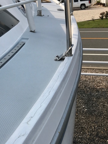

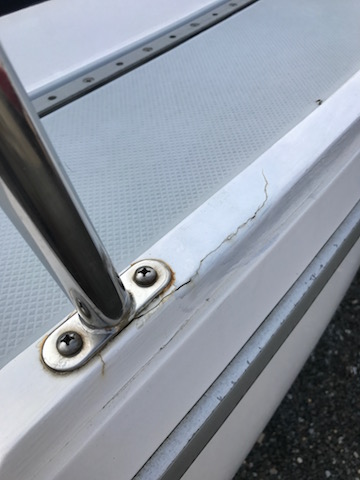

Here are some photos of the cracks, which on second look, do look like they are caused by stress on stanchions.
If they are not structural, they look like something I can repair myself. They are mostly on the starboard side, port has on crack under a stanchion. The rest of the deck isn't showing any spider cracks. Need to give it a closer look.
I'm not jumping in yet, just giving it some thought and doing some research on this model boat.
Appreciate your thoughts on whether these cracks on the toe rail are cosmetic or structural.

I have not seen cracks like that. It is certainly possible that the cracks could be associated with the stanchions. Do you have backing material to secure the back side of the stanchion or is it just bolted into the deck?

@jssailem I haven't look inside yet but did read a review that noted the stanchions were thru bolted with large washers instead of backing plates.
I am going to try to get the HIN this week and then call Catalina and see if they can tell me the construction of the toe rail. It looks like the toe rail was something added onto the deck instead of being a part of the deck. If it is all fiberglass I can probably fix it easily. If the toe rail is wood cored for some reason then the repair would be a much larger job.

Ward, Based on the use of Philips screw heads I'm guessing the size of the screw means a small fender washer at best beneath the fiberglass. Can you see the bottom of the screw from inside?
I will further conjecture that it is probably just fiberglass and not cored material. I hope it is not just a course threaded screw. You really need bolts and a backing plate to secure stanchions. Examine the butyl-tape technique on MaineSails website for sealing the base and bolts for the stanchions. It has served me well the past 2 years since my last repair.

Yes John, I follow MaineSails potting and butyl tape technique on all my deck penetrations, at least where possible, on my current boat.
From the outside it looked at 1/4" round head machine screw and only two of them, which does sound light.
