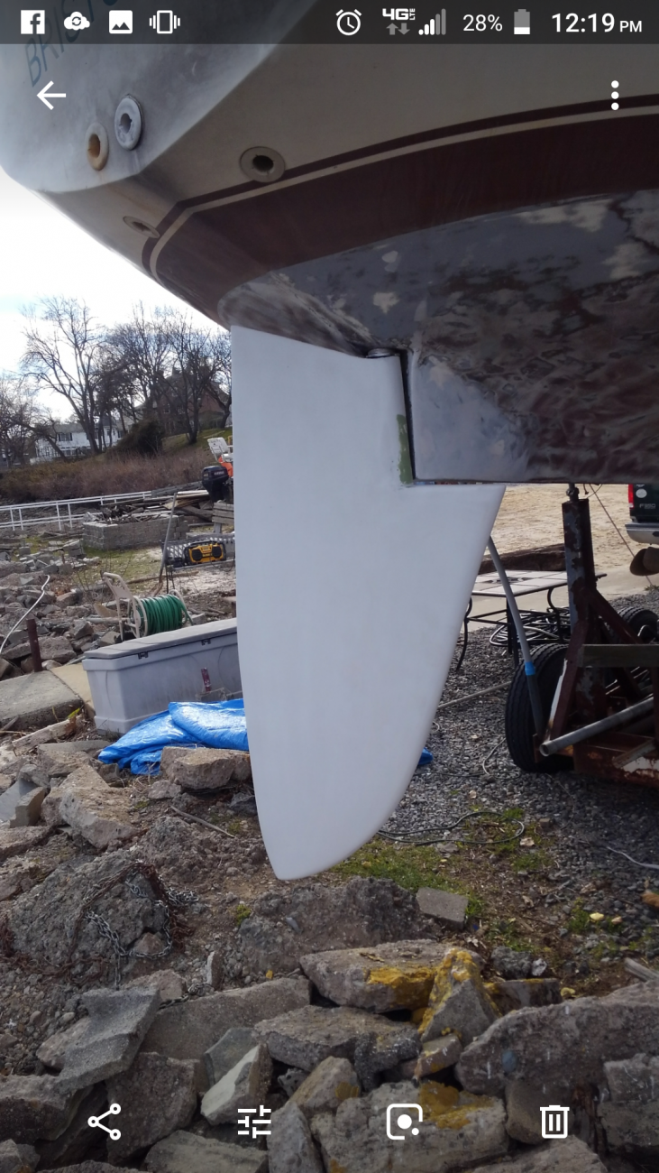

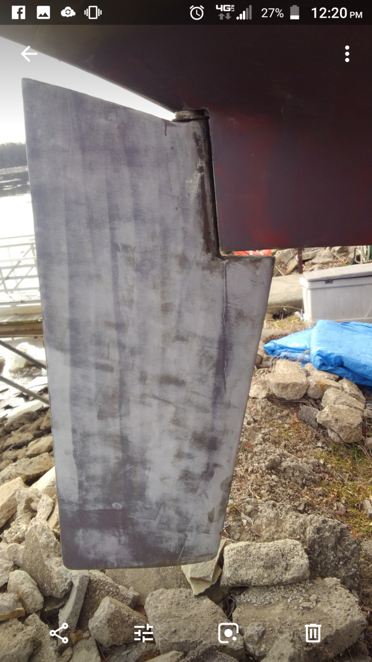

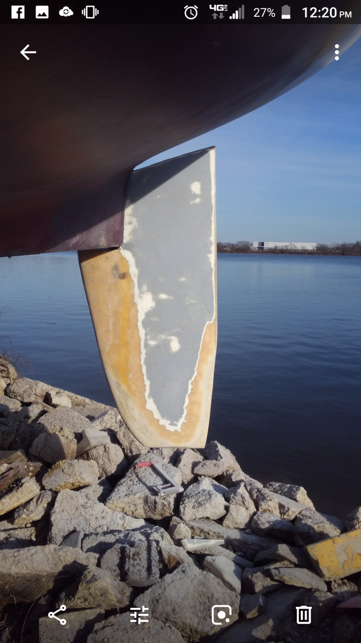

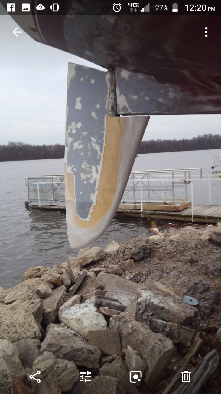

I thought Id share my rudder rebuild. it's been the best upgrade I've done so far. Boat handles so much better. I add 3 inches to the top front and 4inchs to the bottom. Trimmed about 1 1/2 off the back tapered up to the middle. I was told to make it look like a orca fin.
