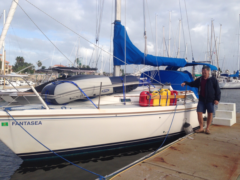

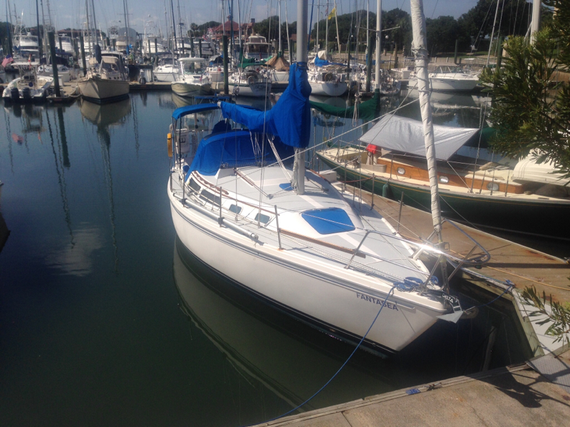

hvbaker - I'm planning to go gray also - yours looks great!!
Oct 5, 2010
322
Catalina 30 mkII St. Augustine
Thanks guys! The rub part of the rail itself does fit into the aluminum rail. Mine pulled out quite easily - hardly had to pull on it. hvbaker - I'm planning to go gray also - yours looks great!!
Thanks. The old one came out very easy. The new one going in was quite another story. The new one has not come out even if the rail goes in the water. The old one use to come out quite often.
