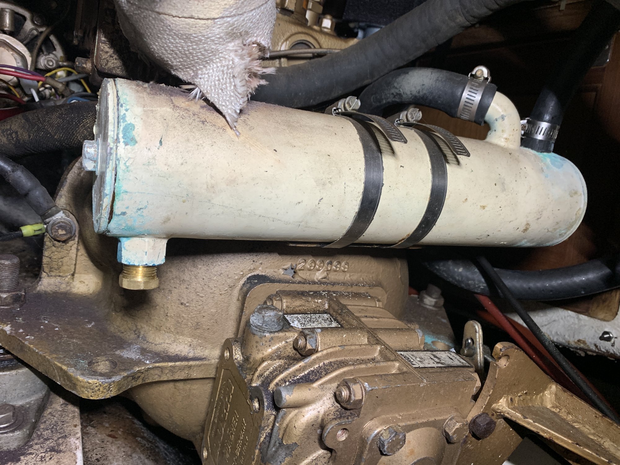

Hi there, I'm looking for some advice. I'm going to change the heat exchanger pencil zinc on my universal M25. I closed the raw water intake valve and then unscrewed the socket to replace the zinc on the heat exchanger, I was expecting some water to flow out, but it just kept coming... the valve is defiantly closed or so I think.. I'm a little concerned. Any advice? Thank you!

There's a lot of water in that system, don't be surprised. Look at how long the hose run is from the thru hull to the rw pump to the HX, and it's most likely a 5/8" hose.
Two ways to deal with it: 1) If you want to assure your thru hull is closed, just wait until the water stops. 2) Don't worry and just replace the zinc.
Good luck, either way not an issue.

On my 3" heat exchanger, about 3 cups of water drains when I open the zinc nut. How much water have you seen comming out? I capture the water in a 1gallon zip bag, some spills in the engine bilge which I drain out using a syringe. You can also view the water strainer to see if it is emptying out. If not then your through hull valve is not closed.

Thanks Joe. more than that, at least 3 gallons so far. i have the valve closed but maybe im missing something

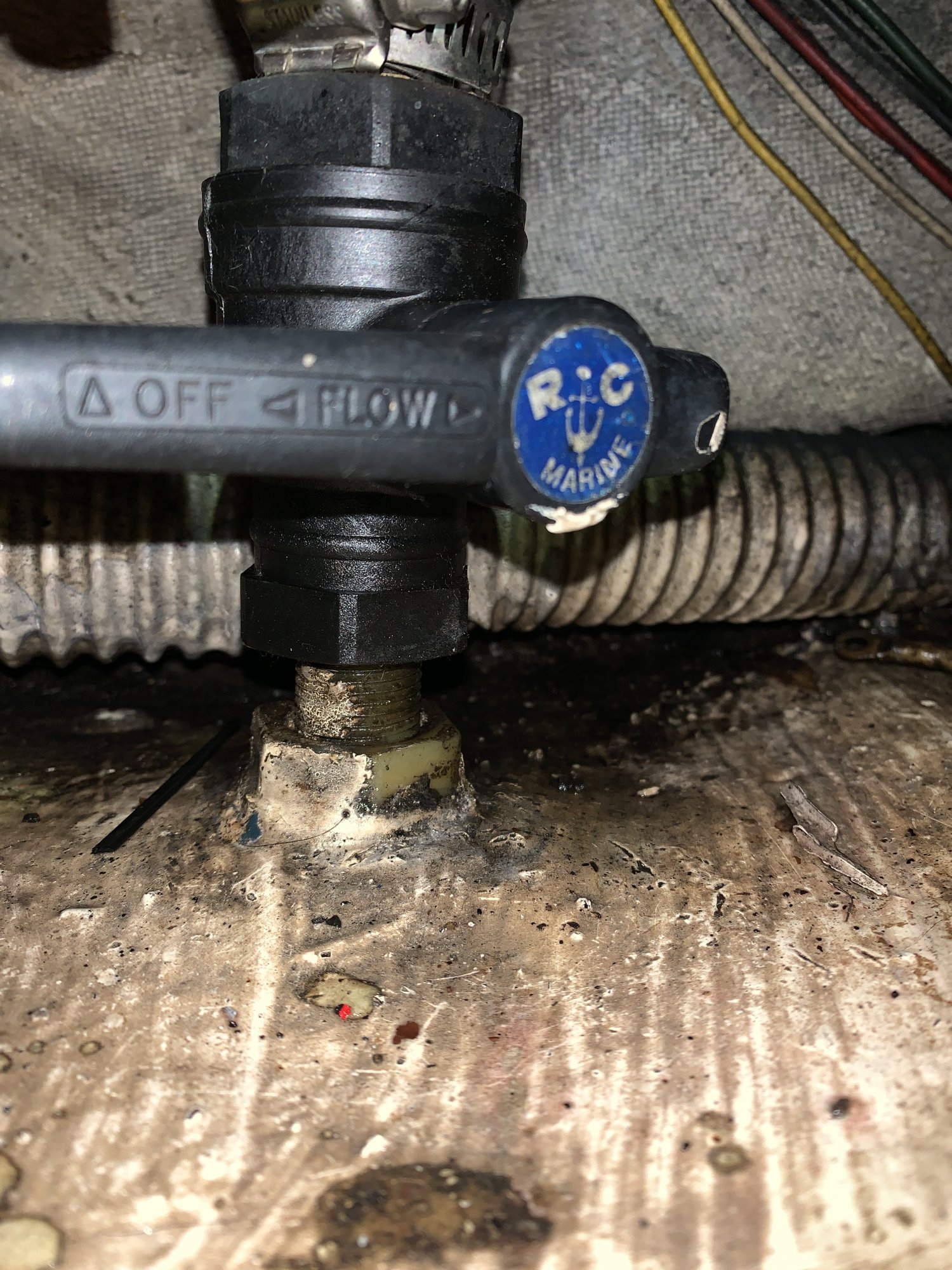

Jan 7, 2011
6,014
Oday 322 East Chicago, IN
That definitely should be the closed position for the valve.
Greg

Apr 8, 2010
2,257
That's an RC Marine valve, from the 80's. ForeSpar bought them and redesigned the product in the 90's.
If the handle rotates firmly from the open to the 90 degree stop position it should be OK. But it might be a time to move forward in technology.
We changed all of our OEM RCMarine thru hull valves out to the better-design ForeSpar 93 series seacocks in the 90's. Good product with no worries about electrolysis.

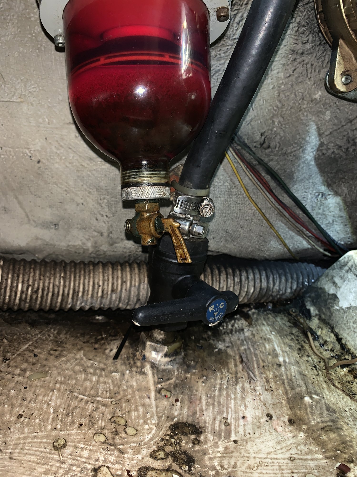

Apr 5, 2009
3,333
Are you sure that you are closing the correct valve? Most C30's have three thru-hulls near the engine. [galley sink drain, engine cooling intake and macerator discharge]
To test to see if the valve is fully closing, you can open your sea strainer.
