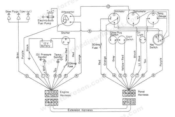

You didn't say what engine you have but if it is a Universal M series there was originally a fuse in the yellow / red wire on the engine side of the harness before the starter. Hopefully your wiring isn't original but you might want to check there or ask the electrician if they did.
Additionally, that wire at 16 gauge, was woefully undersized and has been responsible for many starter inactivation problems.
Apr 8, 2010
2,240
If that '84 Catalina still has the OEM Universal M25 diesel, there is a good chance that the starter button has corroded away inside. Also, you need to replace both of the "trailer connectors" in that wiring harness before they overheat enough to start to smolder or start a fire. Most owners either replace the harness with larger diameter wires or at least install terminal strips in place of the woefully inadequate "connectors". Great engines, at their heart, being a marinated Kubota engine.

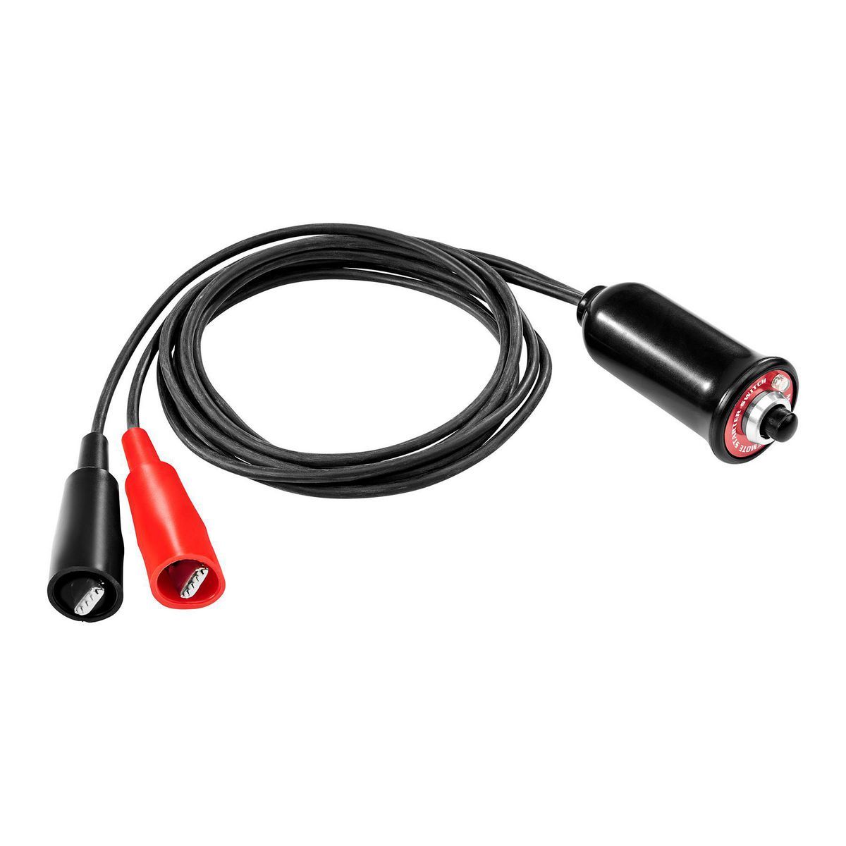

Stay in sequence and you might save yourself a great deal of work and perhaps, money. Start with the simple things first, like the neutral stop switch. Your gear shift may not be in neutral! There may be a blown fuse you do not know about in the ignition system. There's nothing complicated in determining if it is the solenoid that is your problem. Buy a remote engine starter starter, as below. If the engine starts using that, then it is the start button, or the wires to it!You should have one onboard, anyway.
I'm sure everyone has mentioned cleaning contacts in the wiring, but do not neglect to check if the wires are properly swaged. Really pull hard on the wire as it may appear to be good, yet it isn't. If none of that helps, you will need to pull the starter and take it to an alternator/starter shop. A starter repair is not particularly expensive as long as you are not at a place that is a "marine" shop.
