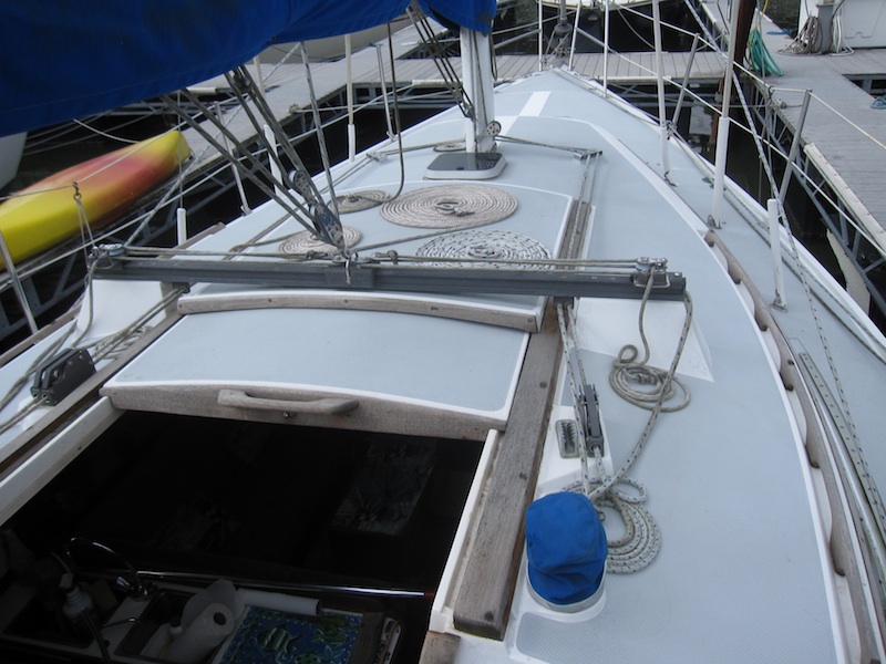

I'm having a bit of an issue with the mainsheet on my new to me Catalina 30. When rigging the boat for the season, I ran the main sheet down the port side where there was a double rope clutch. I'm running it through the rope clutch to a self tailing winch. Getting the line through the rope clutch was a challenge as the line appeared too big (too large a diameter). Now there is excessive drag on the sheet even when the rope clutch is disengaged. The mainsheet was replaced by the previous owner and from the looks of it, it is 7/16ths. It looks like the previous owner purchased the kit which is sold on ebay from "cajun4rope" as the majority of the running rigging is newer. Has anyone else had similar problems?
I guess my question is:
1.) Am I running the main sheet to its intended spot, port side inboard rope clutch, to self tailing cabin top winch.
2.) Am I better off purchasing a new, lighter main sheet (maybe 3/8th's?)
3.) Am I better off purchasing a new, larger rope clutch. Currently the outboard rope clutch is used for the jib halyard.
Thanks for any insight or similar experiences.
