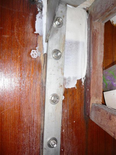

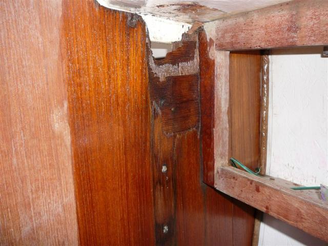

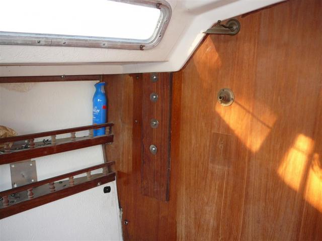

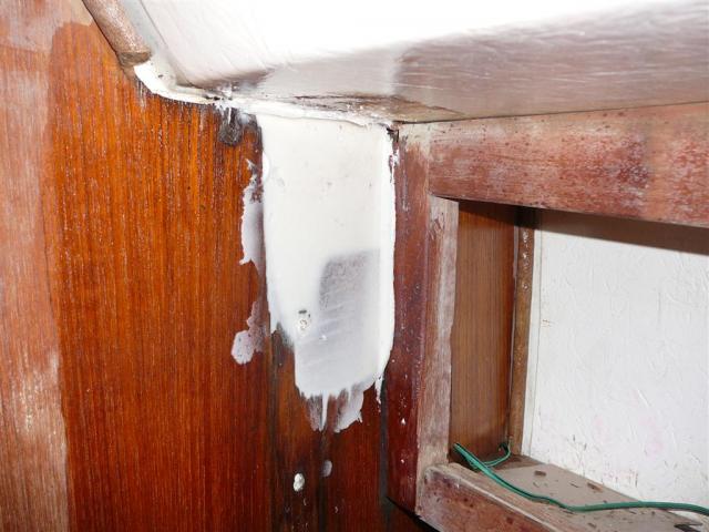

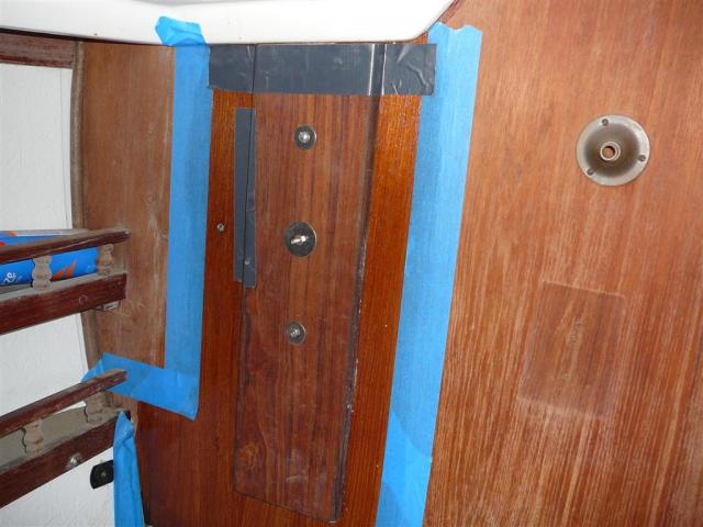

jeremy, I am no expert on anything so take my comments for what they are worth.
I chose to use Smith's Penetrating Epoxy, which will keep the wood from rotting further if you can get it dry. I ran a dehumidifier in the boat for weeks, and rolled many applications of this stuff on my main bulkheads in the areas where the chainplates bolted thru. I was just not ready to do what SWG did.
On both sides I had a lot of damage...on the port side, I sistered an old piece of teak hatchboard to the main bulkhead (secured with West epoxy) and used longer bolts to go thru everything. On the stbd side, after the Smiths, I did a lot of West with high-density filler plastered into the bulkhead. It did not have as much damage. On both sides, I used HDPE backing plates as clamps (waxed) when I plastered the West epoxy. I put the epoxy on the forward sides, so not as visible in the main cabin.
Some day I'll make it prettier, but at least now I don't have to worry about the stick coming down. Early on, when I first owned the boat, we beat into a 20 knot northerly before these repairs. The 20 knot southerly we beat into last summer was a piece of cake...well, at least I had piece of mind.
here are some pics of the port side.
