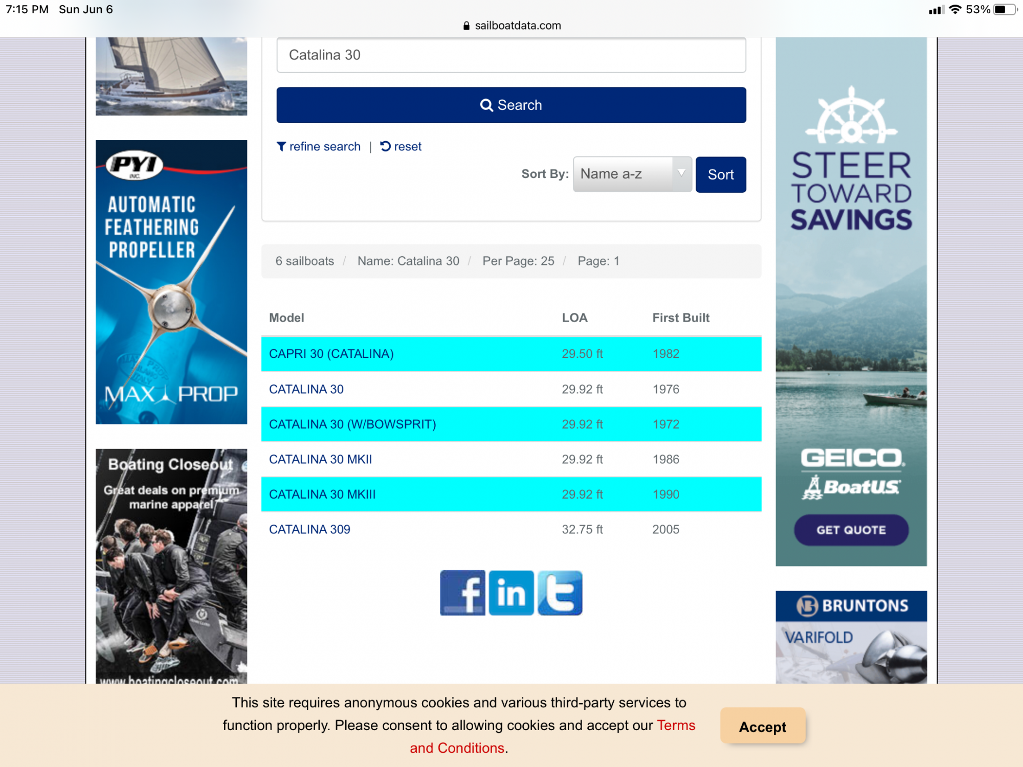

You don’t mention what year, it based on this data, it doesn’t really matter…
42B4EF37-93C7-42E9-B691-BC63426E2D8D.png)
As @jssailem advised, who knows what a previous owner has done to the boat… But I would assume any anchor hanging off the bow roller will put you over the limit…if the anchor counts as part of the boat…

Based on what @Tally Ho just posted from sailboat data.com the length over all of 29.92', which is listed for all C30 models, is the hull length. Note the bow sprit version has the same LOA as the standard rig.
Bow sprit, pulpit and stern boarding ladder are not included in the LAO so you will need to know how much of those options extend the length. As already posted, you never know if the ladder or a pulpit has been changed.
