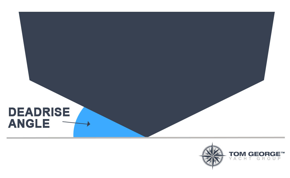

The unit you purchased has a narrow dead rise angle..
Deadrise Angles8-15°
You want to manage this so that beam misses the keel. Do you by chance have a wing on your keel?
The signal being transmitted to the bottom by your transducer has a narrow beam.
Beam Width13°

Yes it is a wing keel and I'm pretty sure the depth finder is just bouncing off the wing. Odd that the original depth finder didnt have this problem. Everything is mounted pretty firmly so I can't tilt the beam. I was thinking about rotating the transducer in the housing. It will probably make the knotmeter not work but I am more concerned about depth.
As for deadrise, the boat originally had the depth finder mounted on a shaped wooden block so it pointed straight down. And that's how I mounted the new one. If I mounted it flush with the hull it would probably point off to the side and miss the wing but the depth would have been off by some sine or cosine but would have been better than what I have now.
