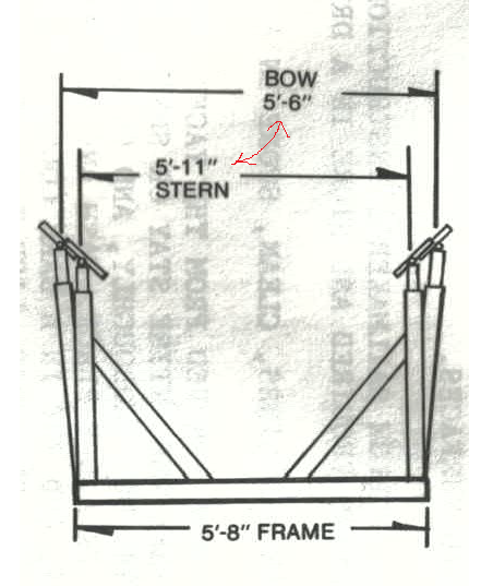

Started looking for a trailer for my Catalina 30 (1980) and found couple manufacturers that can build custom trailers. They are asking for specs and I found one page in the manual that has the cradle drawing, but it seems to have mistake. The stands are mixed, aren't they? Shouldn't the "bow" and "stern" (including dimensions) be switched? This is from page 58 of the C30 manual...

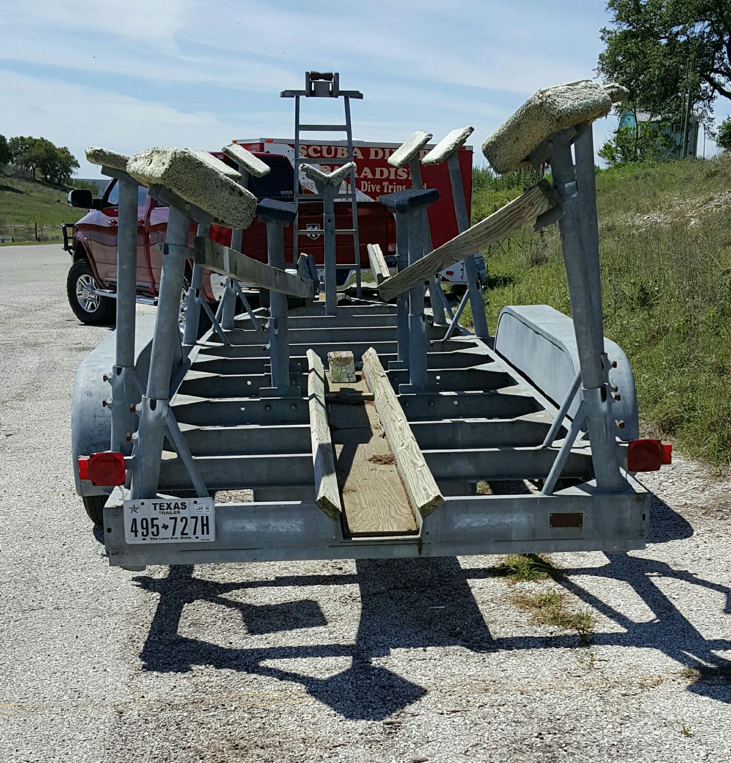

Four sets of adjustable cradles plus a bow cradle. Plus cradles just outside of keel. Widest ones are second from back.

I have a 1992, the cradle is narrower at the bow by 3" according to the drawing in the manual
