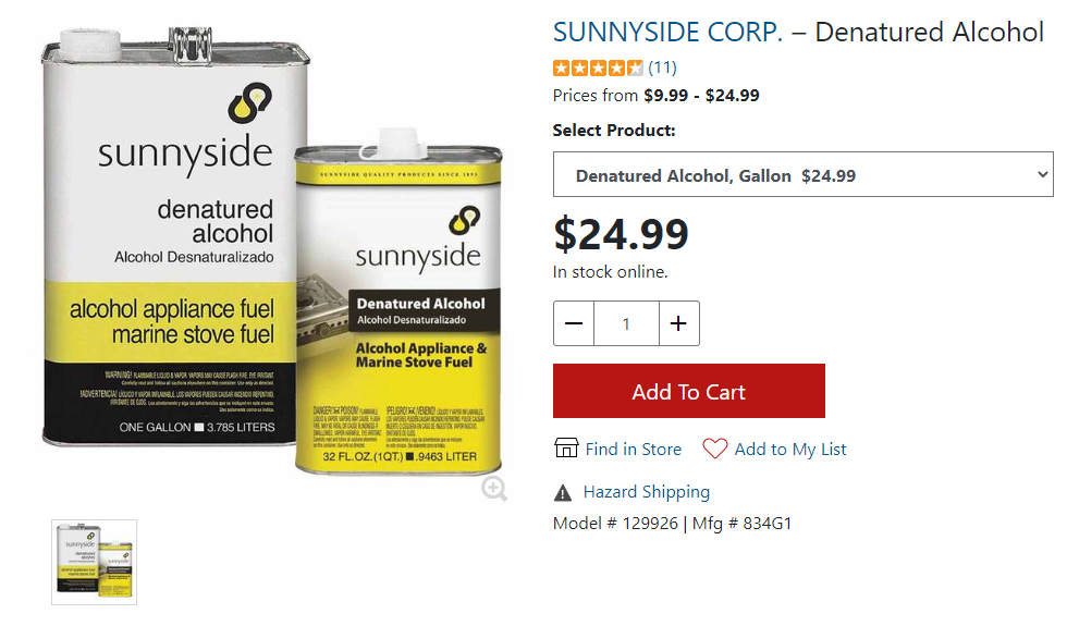

I can help with part of it. What you're looking for is denatured alcohol. You'll get it in a gallon can, usually from your hardware store - even West marine carries it. Its not cheap though - $25 a gallon. But you probably won't use it quickly. Here's what it looks like below.

Regarding type of alcohol, yes, if you can get the clean burning stuff at WM, i'd use that. Honestly, it's like a big camping stove using liquid fuel. You could theoretically use just about anything that burns that would go into a camp stove, but you probably should use the good stuff so your food and boat doesn't stink, lol.
