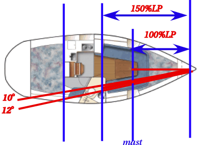

The below pic. shows the approx. fairlead angles for the C270 ..... the coachroof tracks on the 270
seem to be well 'inside' of the normal 10° fairlead-tack angle .... suggesting the need for rail tracks and/or barberhaulers when using a BIG jib.
Simple speak: it 'seems' that the coach roof tracks are 'too far inboard' to be used with a 150% in other than 'very light' wind conditions.
