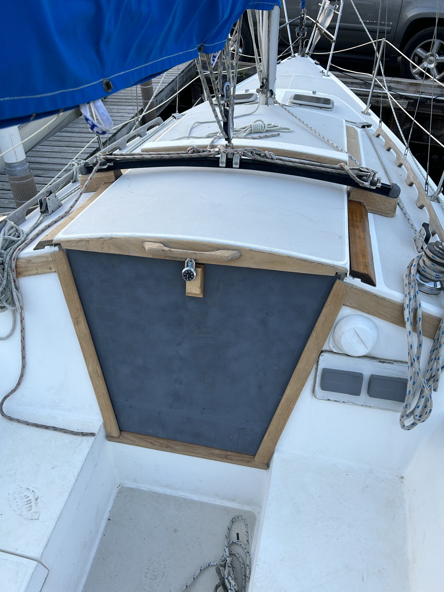

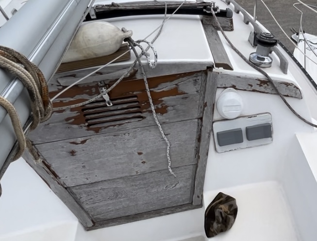

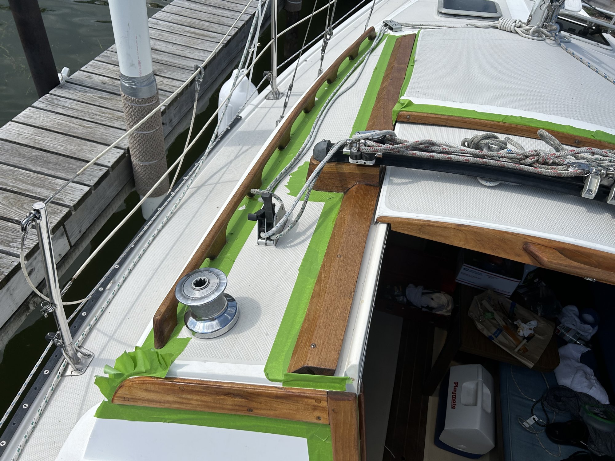

More photos. The Coaming covers were breaking and had gaps. I used Gflex to fill in the gaps and I worked great. It’s not a perfect match but it’s strong so I basically rebuilt the crumbling teak Coaming covers with gflex. It’s sandable. Still need to finish sanding and stain the Coaming covers.

3 coats of sikkens cetol teak.
Super results! I usually apply 2 coats of Cetol natural, followed by two coats cetol gloss. Usually lasts 4 years. Keep an eye on it and recoat at first appearance of it deteriorating. Lightly sand with 220 and apply 2 coats and you’re good to go. No need to strip it down to bare wood again; much easier than the restoration that you did. The boat looks amazing with the teak restored & finished!

Started using Cetol over 25 years ago. Back then it was durable, however, it looked like brown paint. Present formulations don't have so much pigment, resulting in a more translucent appearance as seen in @BTC1984 photos. I like adding the additional coats of clear gloss because it provides additional protective coats without obscuring the wood grain. As previously mentioned, I usually get four years before recoating; not bad for semi-tropical environment with uncovered teak.

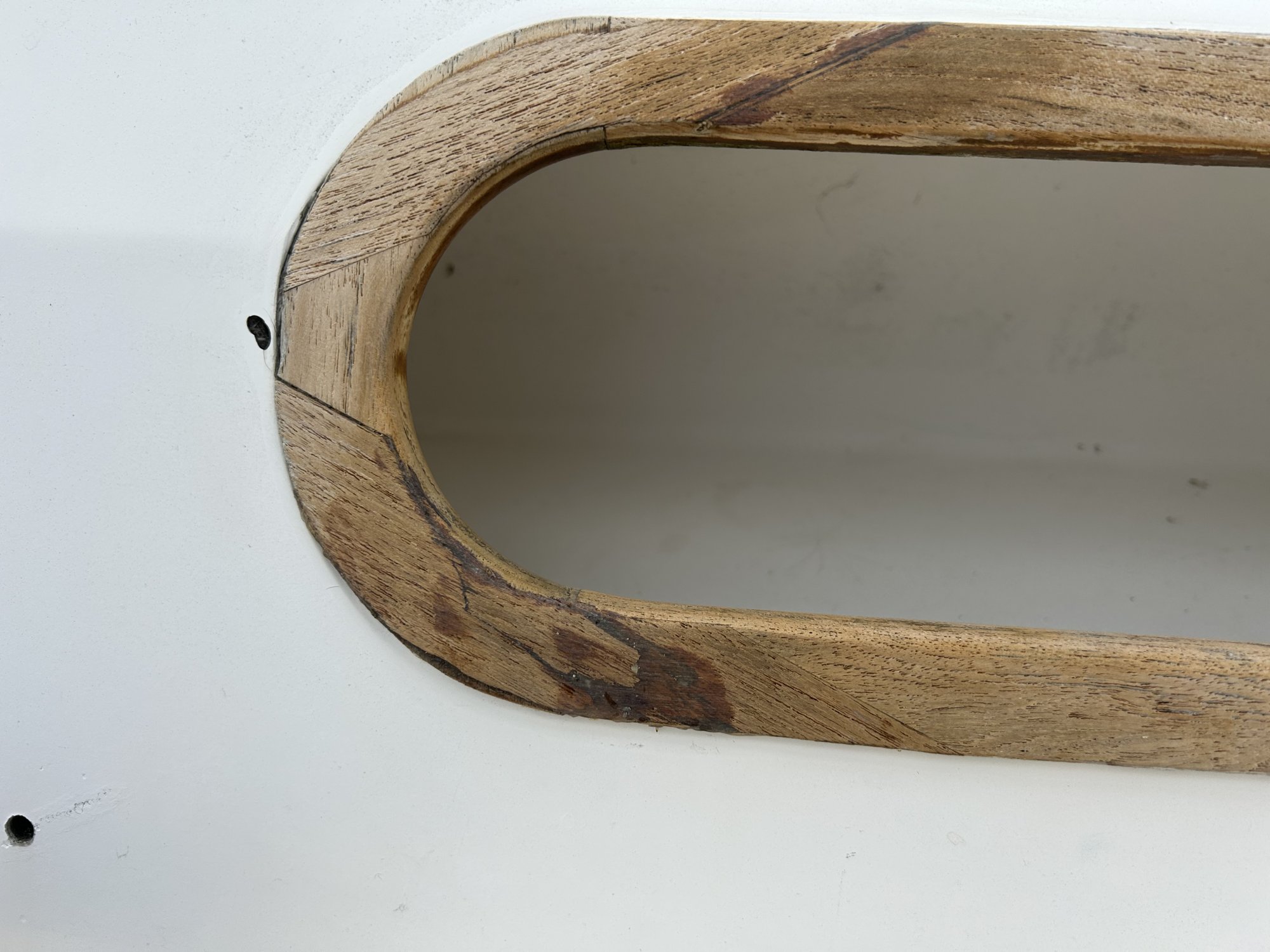

What did you use to fill in the cracks? I plan to redo my teak soon but have some gaps that need filling.

Gflex. It dries rock hard and can be sanded. Plus it has the consistency of a gooey paste so it stays in place until it dries. See my Coaming covers in my previous post you can see the gflex post sanding but not yet coated with cetol

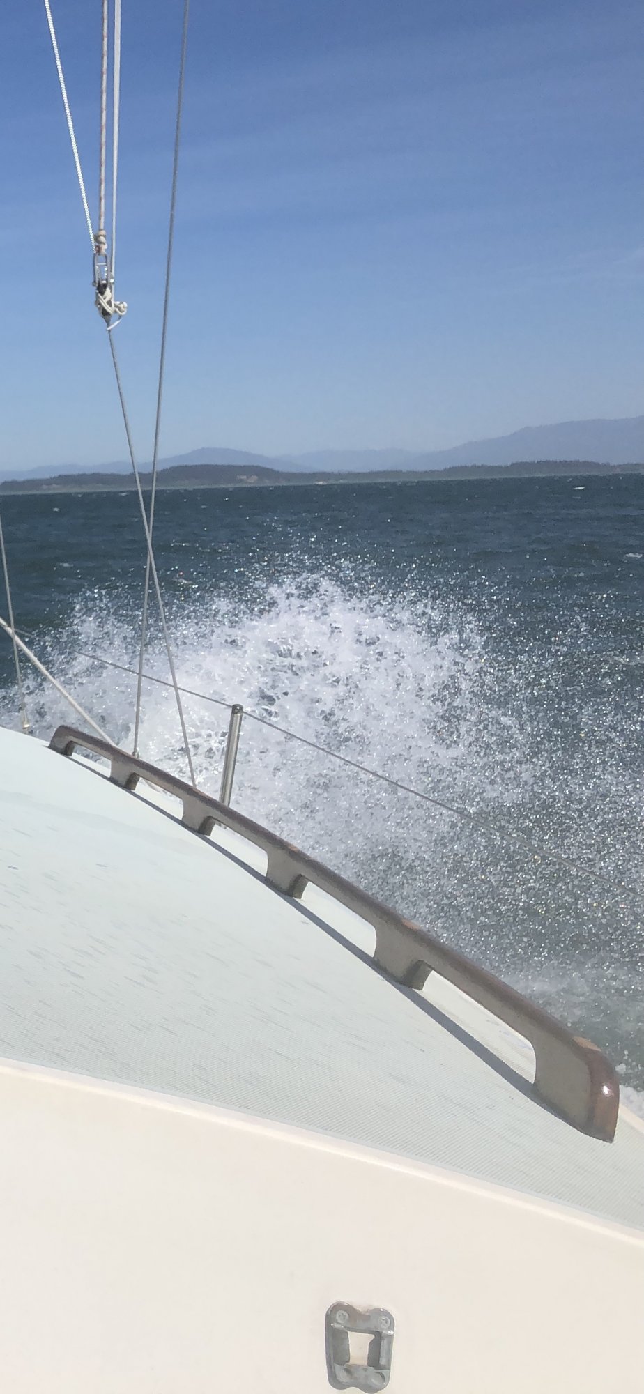

Nevermind the chop, splashes and whitecaps, I'm staring at my beautify teak!

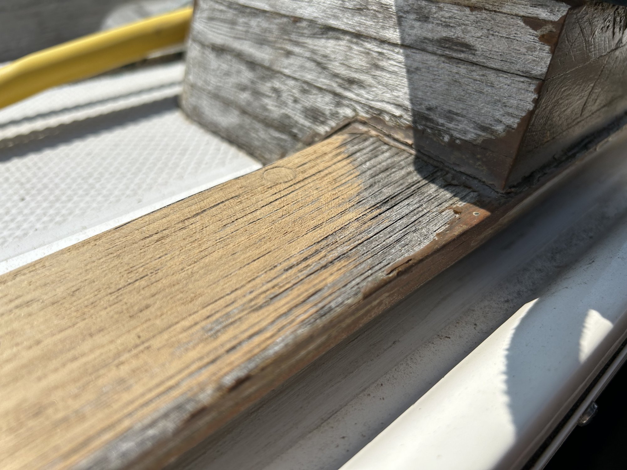

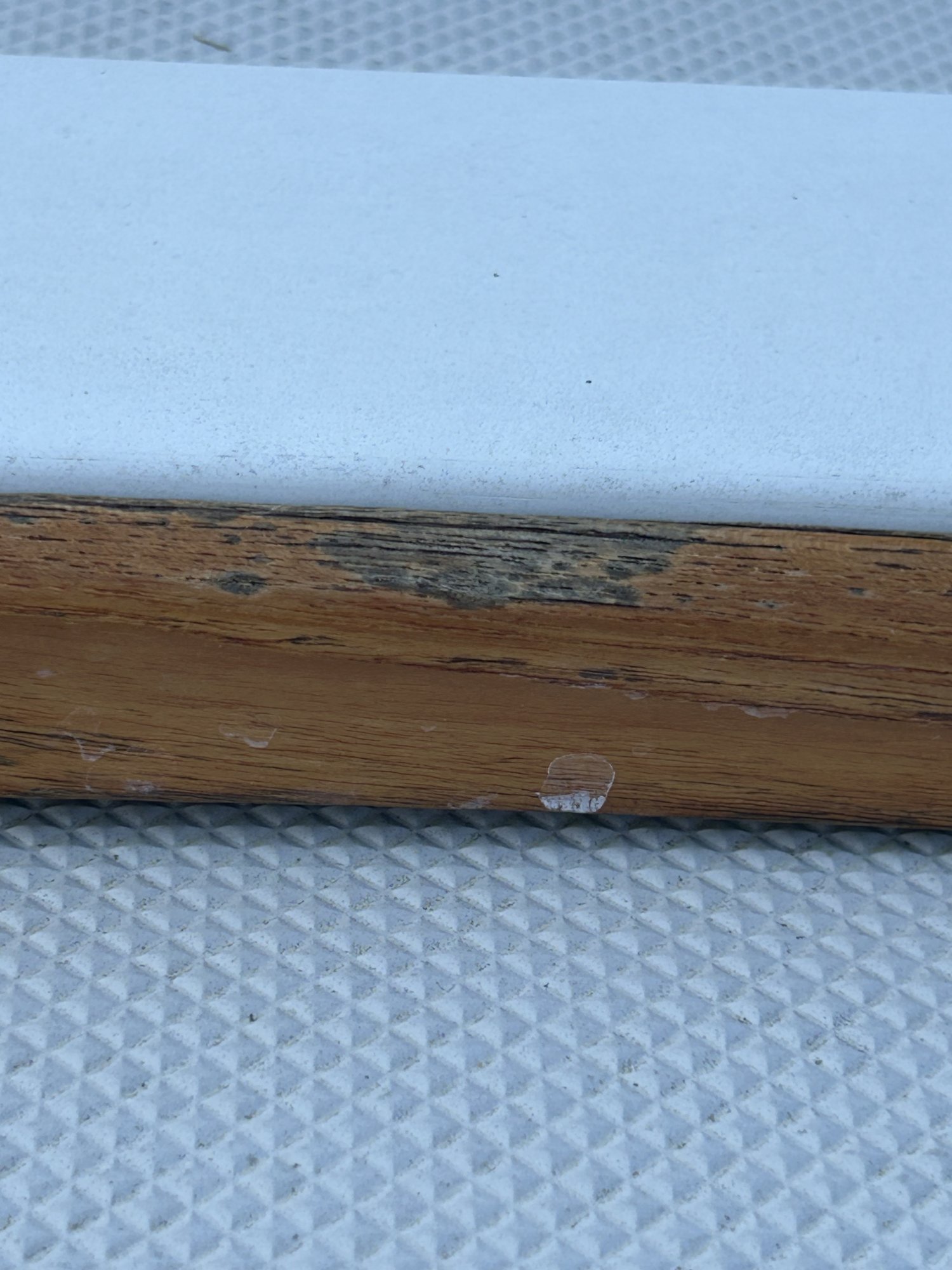

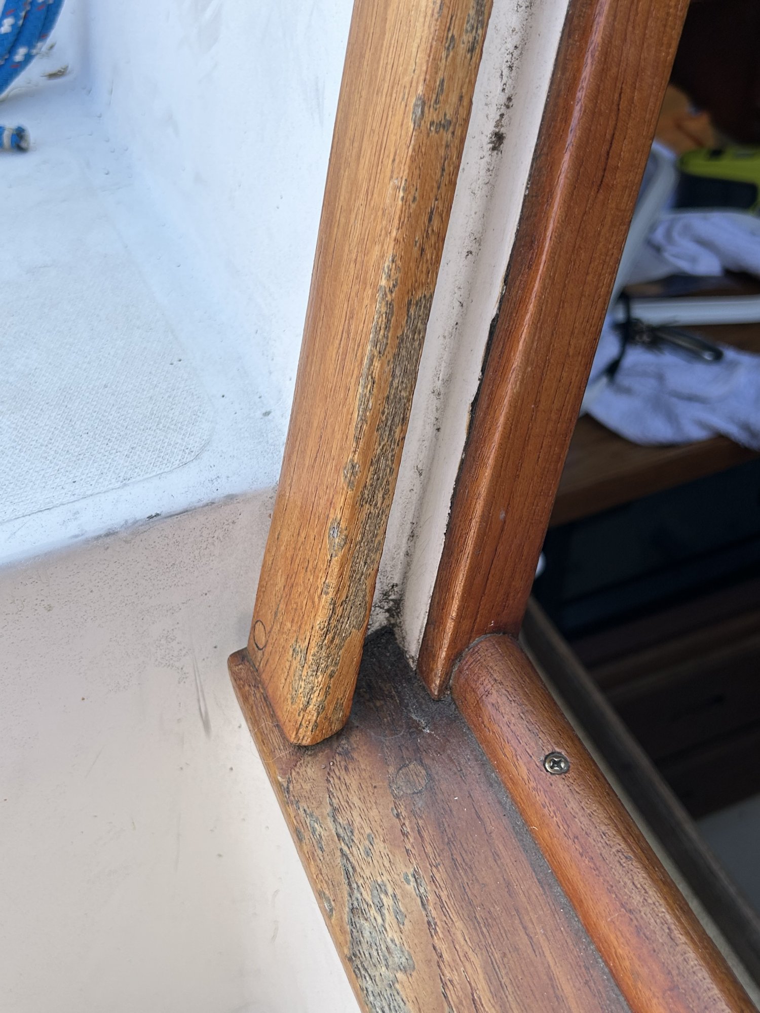

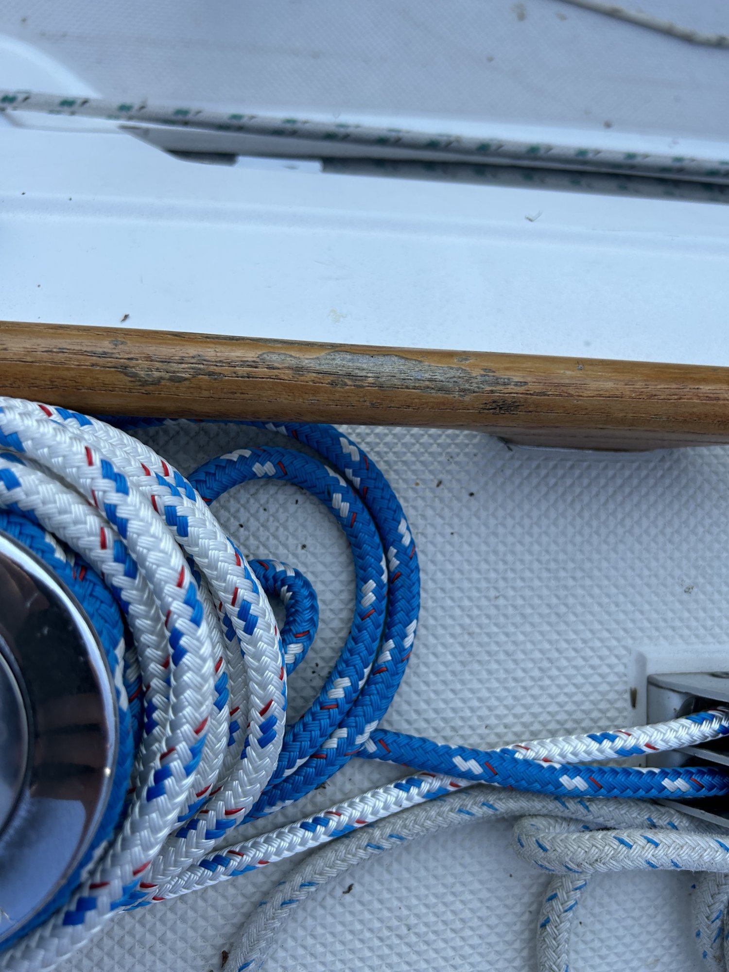

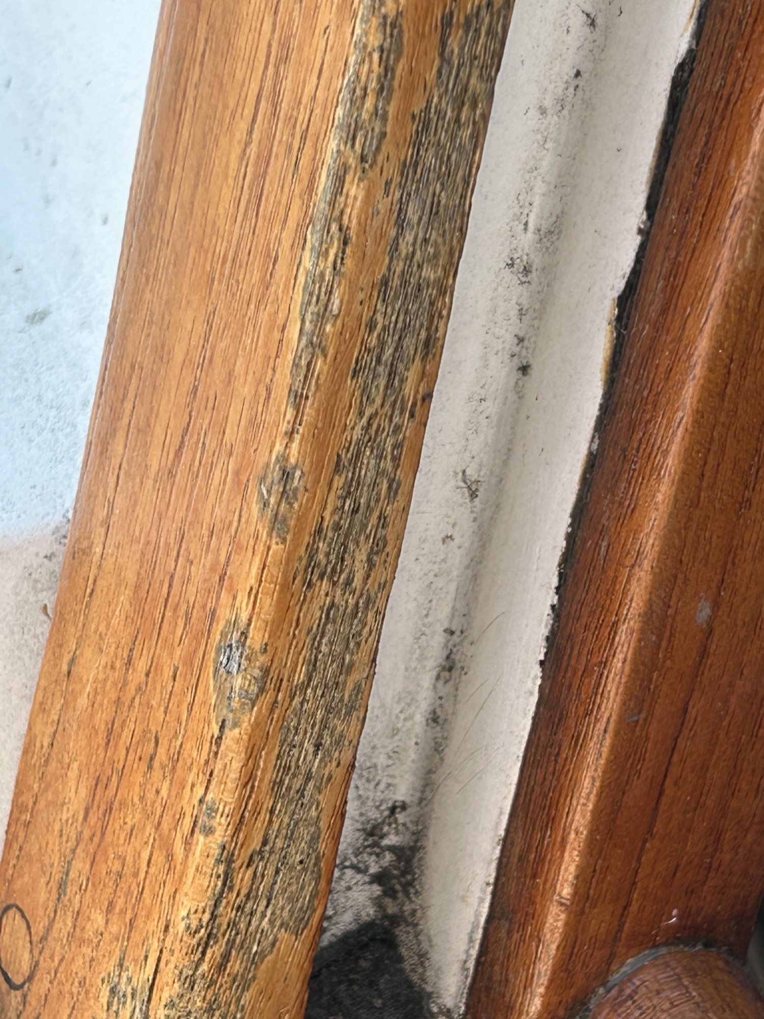

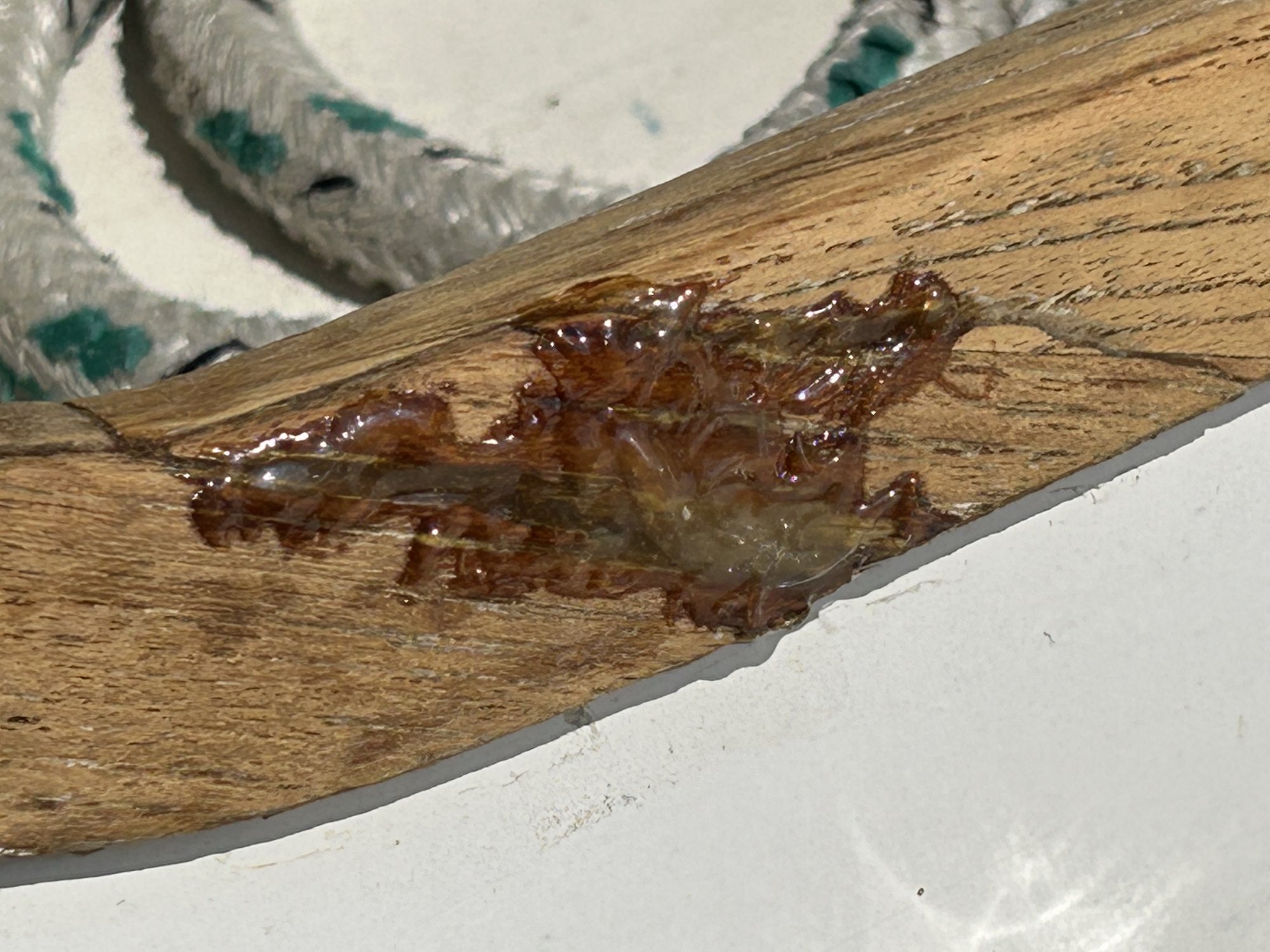

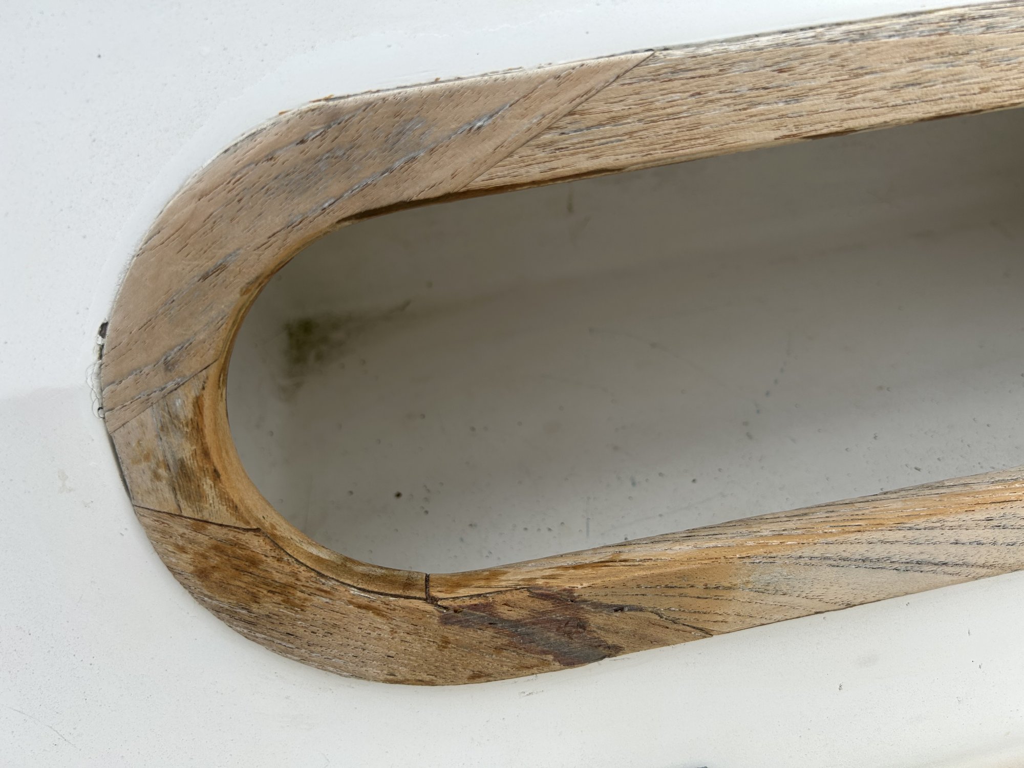

UV damage, what it appears to be. It appears that the wood is not smooth in those areas. That would make it difficult to get complete coverage in all of the areas. Dirt gets into the small crevices. That stops the varnish from getting a complete covered film to keep the water from the wood.
If you can not sand smooth all of the wood then you may need to fill the wood, seal the wood, then apply multiple coats of varnish.
May 7, 2023
79
catalina 27 lake st clair

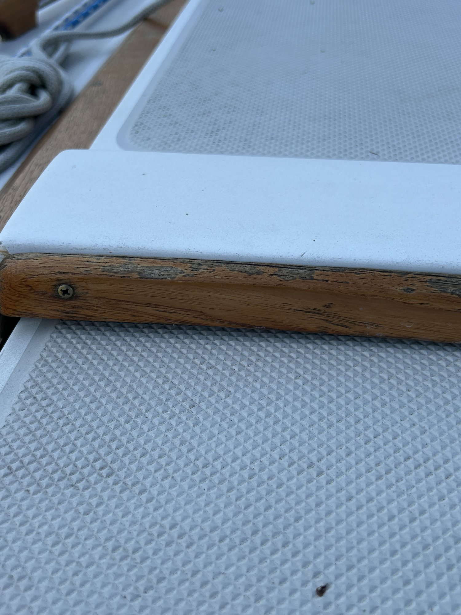

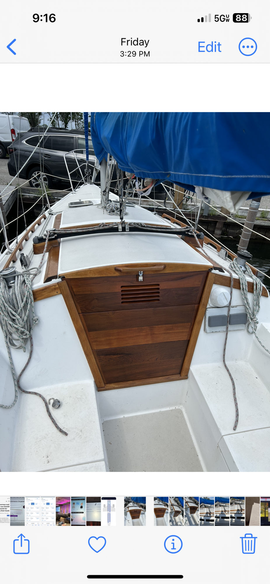

Thank you. What peaks my interest is the disparity between sections of teak, ie the “failure spots” as shown in the photo. To me this suggests poor surface preparation as the problem. It could be argued the thickness of the sikkens varied in the failure spots but I just don’t see that as likely. That being said on my companion way boards, they look as good as new. No failure spots. Two things were different with the compassion way boards. First I was able to sand them and prep them very well. (Off the boat -At home) and I was able to apply 3 nice thick coats of sikkens simply because they are easy to work with.
With varnish, I have found a series (6plus) of thin coats last longer than a thick heavy coat. Something about the stretch of a thin layer, I conjecture. It is recommended in instructions from marine professionals. Wooden boats often have double digit coats that required sanding between each coat. This stretch’s the process out over multiple days.
I have been using Total Boat products. They recommend upto 3 coats can be applied without sanding between coats. This has helped.
