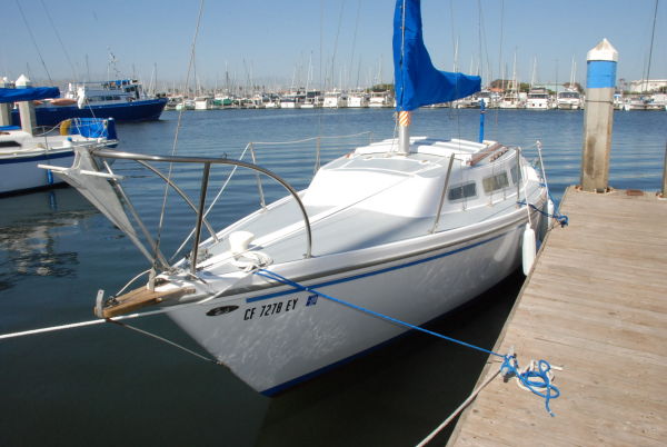

Yeah, I don't know if I've seen it in a print brochure or any such place either. They are listed as a separate rating in our local PHRF, and Sailrite has the sailplan measurements for both. I only know of them because there used to be a couple in our marina. I don't think they are here now. One from San Diego recently sold on ebay for a bargain price.
22,780
Thanks very much for the photo. If anything, that sure looks to me more like an owner mod than anything the factory put together. And it could simply be serendipity where two guys in one marina decided to do a "project" together on both of their boats. It doesn't resemble the more rounded sprit used on the C30 factory job. It's very "pointy." :naughty:
Peter, I'd call the factory and ask Gerry or Frank, if you really must know about the bowsprits. The C27 Association link should have answered your question about mast (and maybe boom - the C25 tall rig boom is lower and longer IIRC, no sprit, ever) measurements: take a line to the masthead on a halyard and measure.

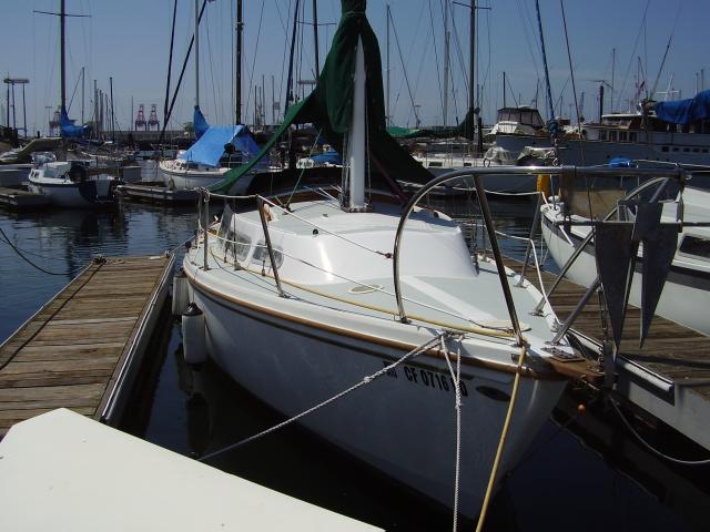

The Catalina 27 Tall Rig has a small bow sprit. It can be found in some of the Catalina web pages for parts. I have a 27 tall Rig and had the glorious opportunity replace the bow sprit and order a number of parts from Catalina to complete the project.

Catalina 27 had a tall rig and it also had a tall rig/bow sprit rig. I have seen the tall rig bow sprit on a Catalina 27 named Down River Rogues that I use to race against in a JAM fleet way back in the day.
You could have the tall rig without a bow sprit. An Uncle of mine had a Catalina 27, 1973 vintage, that was just a standard rig. He knew quite a bit about the boat and all the different configurations it could have (One was an Atomic 4, One was a Diesel, and one configuration had an outboard engine...There was also a dinette version and another model). He told me about the rigging configurations as well.

I can confirm the bowsprit on tall-rig boats. I just discovered this about my 1988 C27 today. There was a diagram in my manual which referred to the length of the boat, and the fact that it is longer on tall rigs due to the bowsprit. Alas, I left my manual aboard (drydocked about 70 miles away) but I'll try to remember to bring it home next weekend to scan the page in question and post it up here.

If your boat has the bowsprit it is a tall rig, if does not, it is a standard rig or a tall rig with the bowsprit missing. If it has the bowsprit your loa is 27' 10" If not your loa is 26' 10"

I have a 27' 1971 with a bow sprit I bought it as a tall rig. But when I compared it to the 27' next to me and measured the sail I found it to be a standard w/ bow sprit
