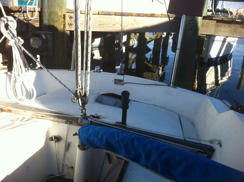

For working my throttle I bought a 14" tiller extension on Amazon for $15. Drilled a hole in my hatch. Works pretty well.
