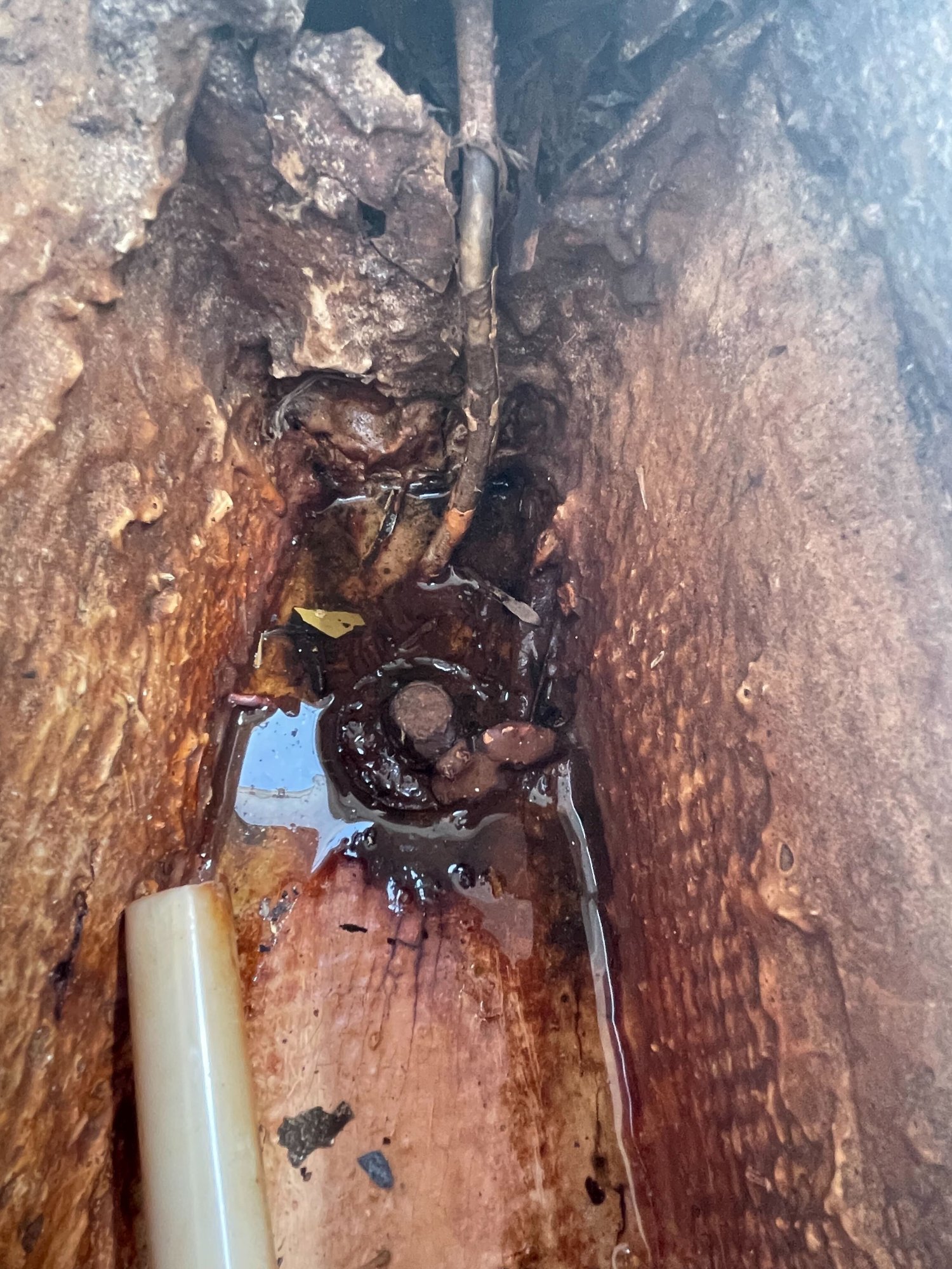

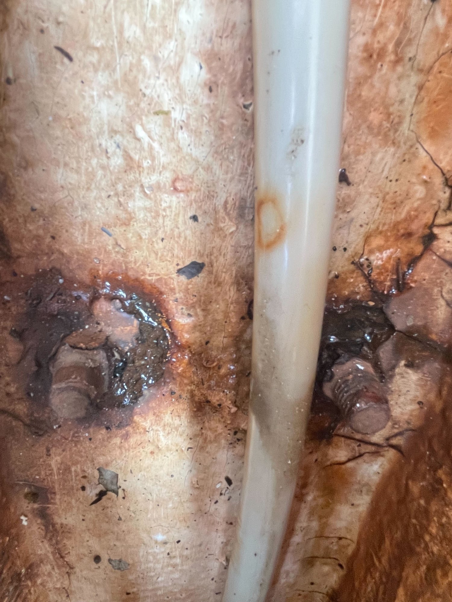

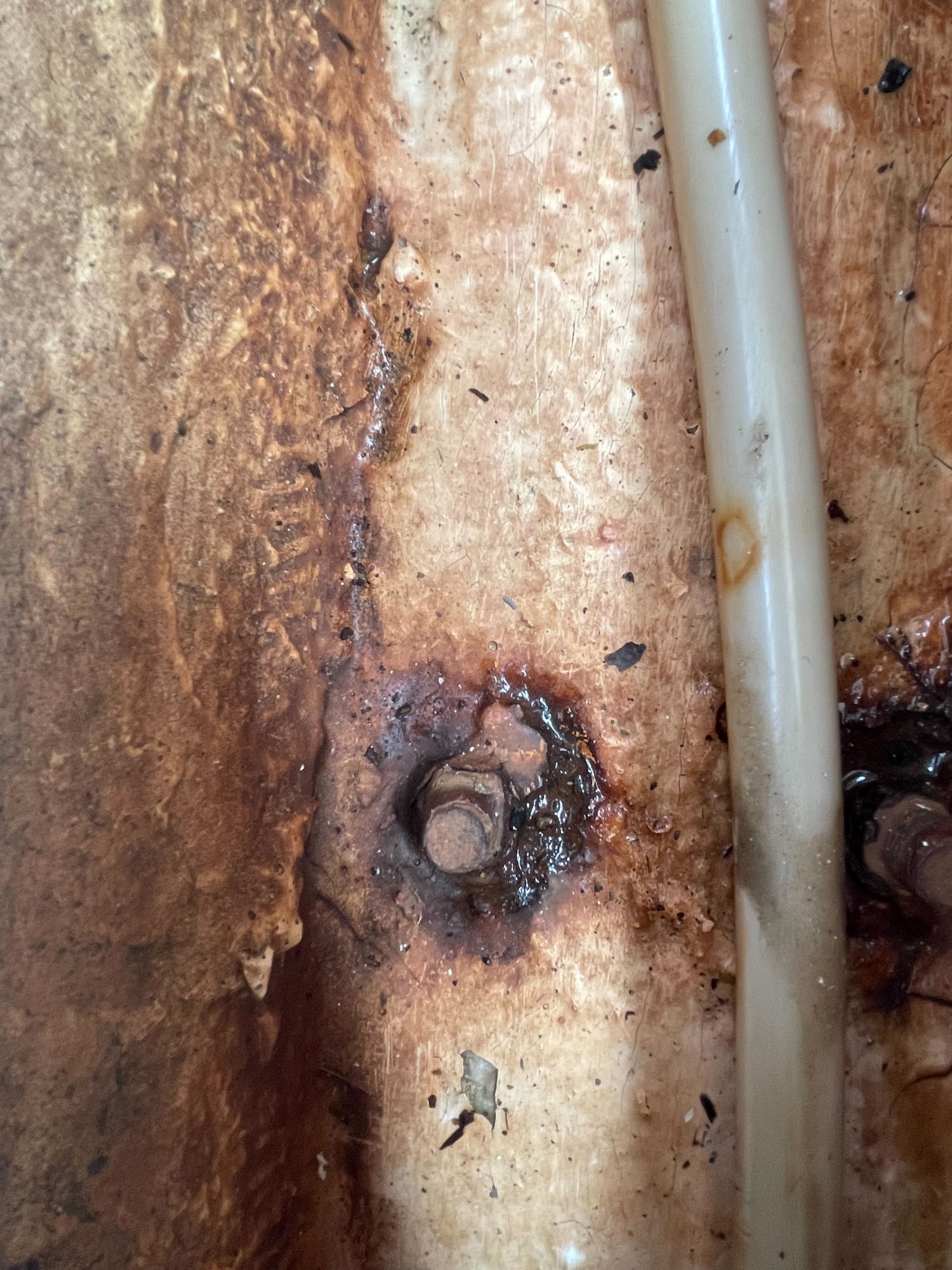

I am in the process of buying a larger boat (have small deposit down but have not yet committed). Everything is in pristine condition on the interior and exterior. The only rub is the health of the keel bolts (they are quite rusty) - its priced super well. Some rust is to be expected as it's a 1975, but I do think this sat with water in the bilge for some time, and I don't think there has ever been a refit. There is absolutely 0 Catalina smile and the exterior of the keel looks great. Sanded and painted every year, sits dry over the winter. No softness around the interior bolts. Brackish water.
Are these a dealbreaker for you all? I know Catalina sells a refit kit w/ lag bolts that penetrate into the keel. Curious if you have ever dealt with something like this and/or undergone a true refit (new bolts, removing the wooden core, glassing that area). Losing a keel would be a real PITA in addition to a huge safety hazard (sailing in pretty light waters + wind). Though presently, I'd be a lot more worried about circular cracking around the bolts themselves, potentially indicating the wood is rotted out. I've never heard of one of these boats losing a keel.

Not wise to make a judgment based solely on pictures. Before buying, I’d have the seller remove one for inspection. Might be a non-issue but …..

Are they stainless or plain steel? A magnet may help to determine. If they are plain steel, I would think they should be replaced. If they are S.S., see if you can clean one up. As Don says, you have to remove at least one of the nuts to see what's underneath. Try to determine if the sealant around the bolt where it passes through the fiberglass of the keel stub has been compromised - if so, there may be corrosion you will not be able to see without dropping the keel.

I have a 1976 C27 and my keel bolts are in similar, perhaps even worse condition. On the plus side, the previous owner removed the wood block that sits under the bilge and replaced with fiberglass. He also installed bronze lag screws down through the bilge and into the keel. I don't know what other posters on this forum mean by saying your keel bolts should be "replaced". That is basically impossible on these boats as the bolts are L-shaped and encased in molten lead. There is no way to unscrew them. The other proposed fix from Catalina is to "sister" in new stainless bolts. It's a tricky procedure but not impossible. You should consider that option, which is probably a better solution. While your bolts may be in good shape below the bilge, it's hard to know. If there is no "smile" that is a good sign but many Catalina owners do preventative maintenance of the keel-to-hull joint anyway. Grinding out the joint, filling with new sealant, and tape/fiberglassing over the joint. When doing such maintenance it may be possible to get a peak at the bolts at that interface, but don't count on it (at least not without a significant amount of work, and perhaps dropping the keel.) Lastly, I am pretty sure the bolts on this vintage of boat are not stainless steel, instead they are "mild" steel. Boats with stainless bolts corrode much, much less, if at all.

"I don't know what other posters on this forum mean by saying your keel bolts should be "replaced". That is basically impossible on these boats as the bolts are L-shaped and encased in molten lead"
Mars Keel can replace the bolts - they cut out the section the bolt occupies and cast in a new bolt. You can also tackle this yourself as detailed here (excellent job): Keel Bolts
Sistering in lag bolts is not as good a solution as either of these.
