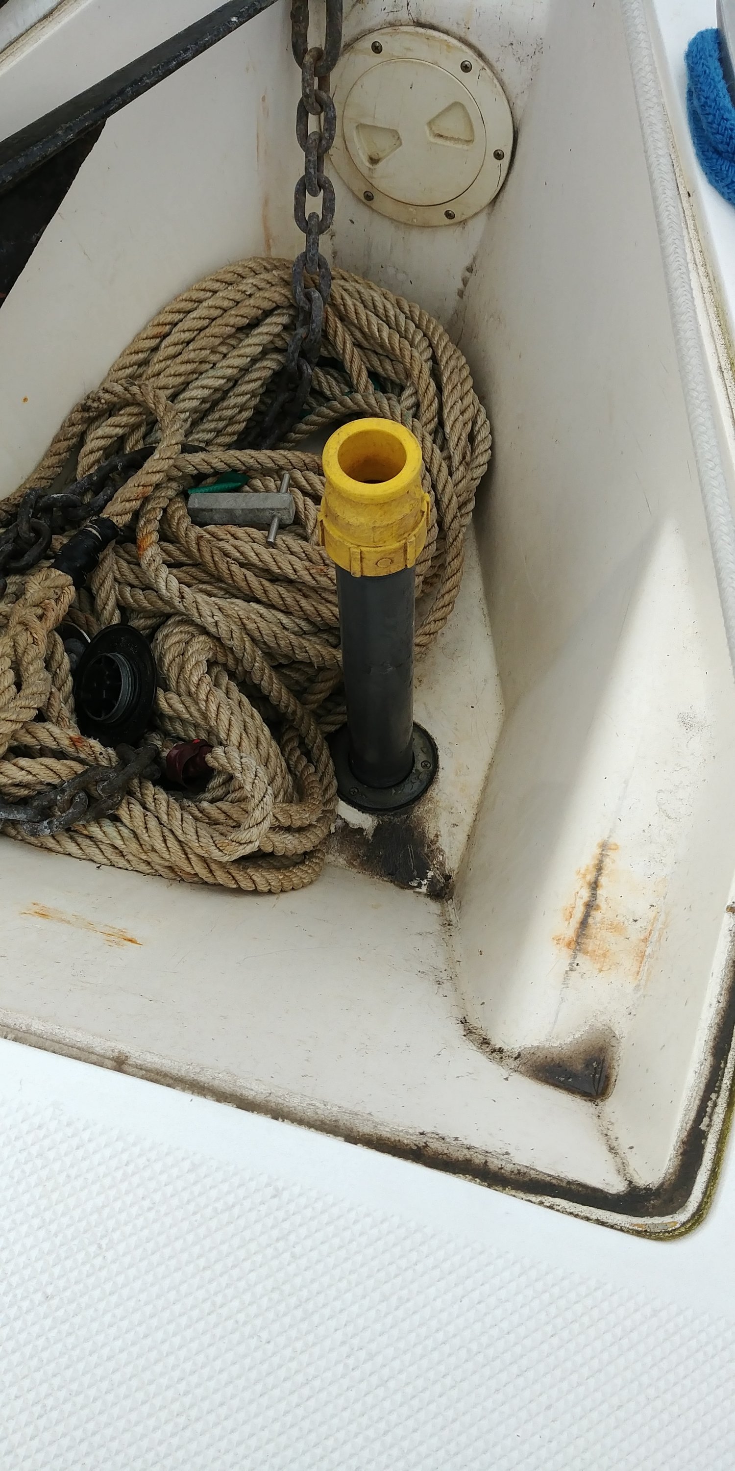

Hi,
I have a 1989 Catalina 27 and I'm having an issue pumping out the holding tank. The pump out hatch is located in the anchor locker and I've been unable to fit a pump out hose in there because of the angle. I've had two pump out boats attempt this and they were also unable to get the hose into the hole because of the 90 degree fitting on the end of the house. It seems like I need a pvc pipe extension to come out about 6" or so to clear the anchor locker. Has anyone run into this problem before and if so what size pipe/fittings did you use?

I have an 86 C27 and I can assure you they do have holding tanks. I'm a little confused. You say you can't get the hose to fit in to the hole because of the 90 degree fitting on the "house"? Do you mean on the pump out hose? Where I get my pump out it is a straight hose and they have a 90 degrees adapter to screw onto it if needed depending on the boat. The OEM pump out is on the bottom of the anchor locker. If it is elsewhere, then it has been changed. My pump out gives me a plastic threaded adapter that screws into the cover threads. The other side of the adapter is for a clam type fitting (same style as used on fire hose or fuel delivery trucks). These come in a range of sizes and materials. I think this is a 1 1/2 inch fitting. The rubber end of the pumpout hose fits into this with no problem and empties the tank PDQ. Once, while away from my home port I did have to get a pump out elsewhere and they did have an 90 ell on the end. I had to take out the anchor and rode from the locker and turn the suction hose around at a weird angle but it got the job done. Maybe a picture of what you are talking about would help.

I had a similar problem on my recently acquired Newport 28 2. The pump out fitting is in the chain locker, and the pump out hose would not fit. The other problem was the clean out port threads. The one the pump out boat gave me had the wrong threads. After a bit measuring, I discovered the cleanout port threads are 1-1/2 inch with 12 threads per inch. I took a barb to not adapter, turned the threads off, then cut a new set of threads. Used a piece of 1" vinyl tubing to the matching cannock fitting that fits the pump out boat. Worked great. The 1" hose allowed enough clearance to screw in the fitting. The tubing is about 18" long. I'm sure there has to be a ready made adapter, but in my case, the pump out was scheduled for the following and I needed a fitting that would fit.

Thank you to everyone that has responded and I apologize for the delay in getting back to everyone. Rick and Joetech have it correct in that there is a factory installed holding tank with a deck fitting inside the anchor locker. The problem is that all of the pump out hoses I’ve come across have a sharp 90 degree plastic fitting at the end that couldn’t be removed and the 90 degree angle prevented the hose from being able to get into the anchor locker and into the fitting. RickD, that adapter looks like it would solve the problem. I’ll have to verify what type of threads I have before buying one. I’ll try to post some pictures this weekend. Thanks again everyone.
