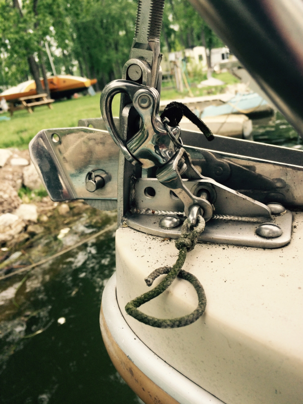

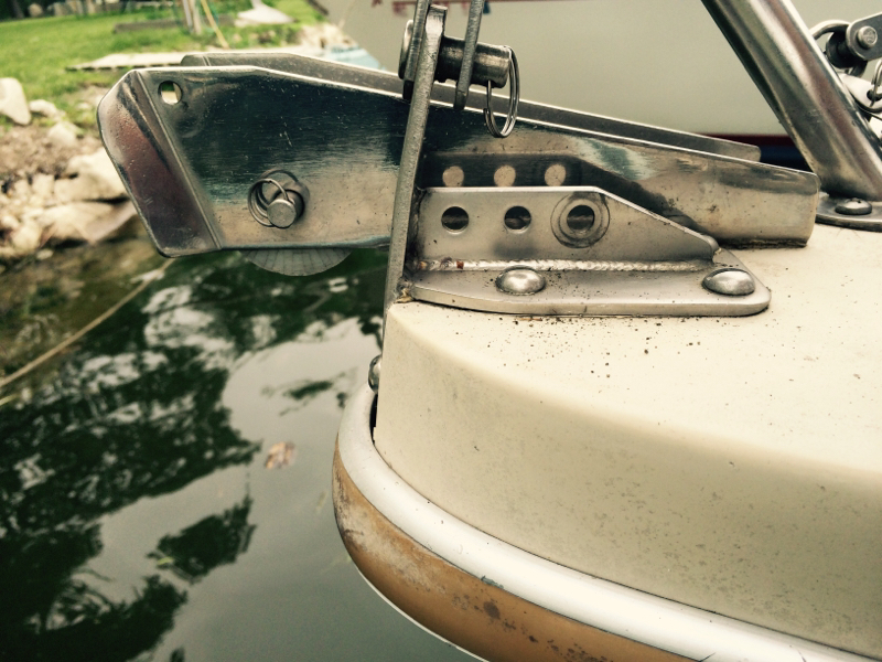

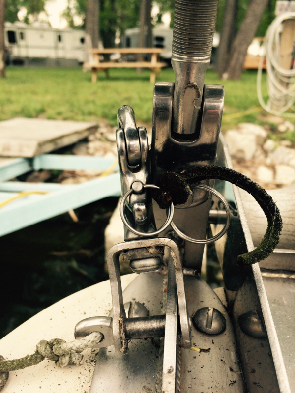

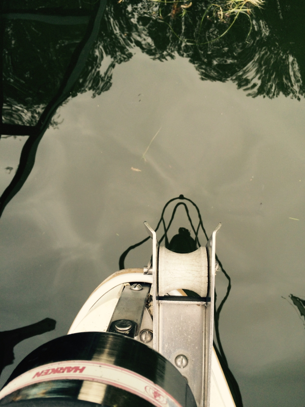

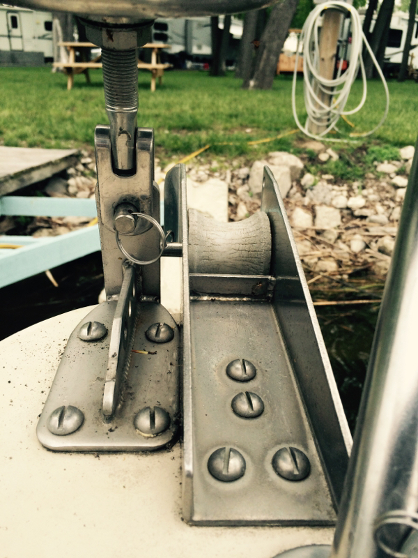

Here's some shots of the bow. The anchor roller is offset to starboard. There are a series of mount points on the boat centerline behind the forestay. One of these had a snap shackle attached as I've put back for the last two images, which might be what had been used to affix a tack block, but it's kind of twisted to get around the forestay.

Good, not too much overhang, which would increase leverage. That looks plenty strong for a light air sail, provided those fasteners are backed up well enough.
I say go for it, and mind the winds. ;)

Attach a block to the hole in the front of your anchor roller.
