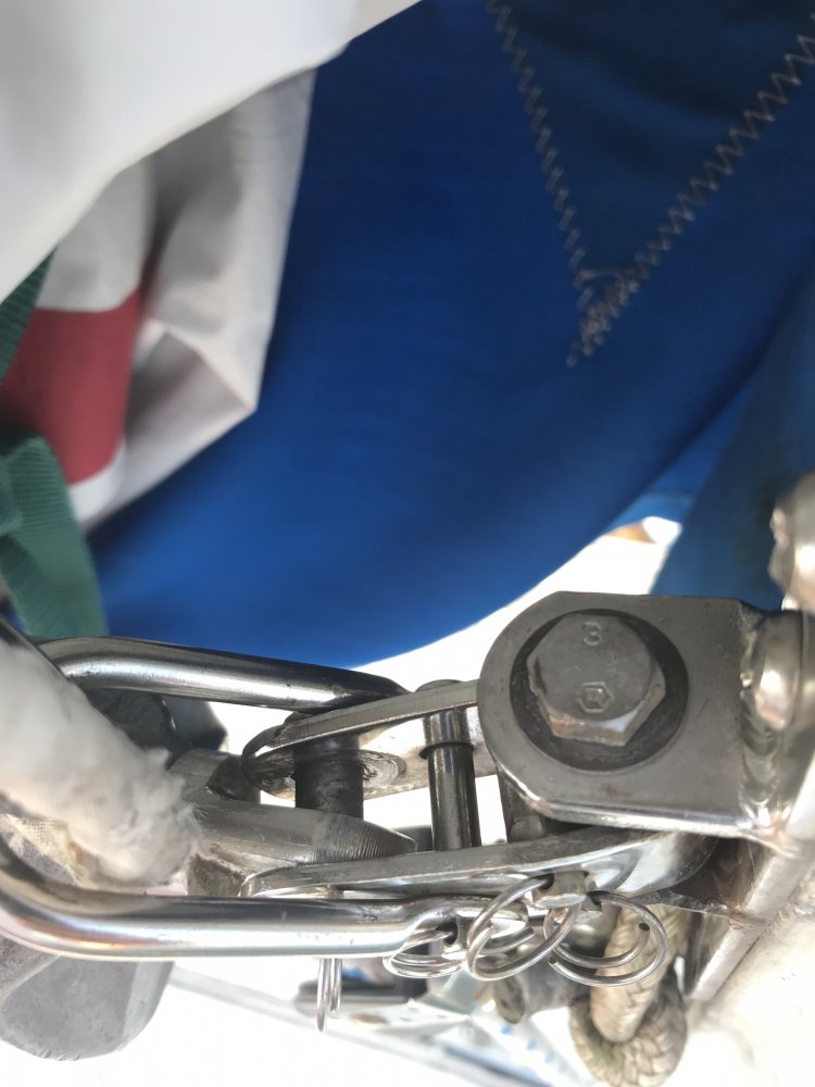

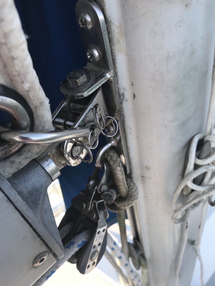

I'm a fairly new owner of a 1989 Catalina 27 and had some questions about the gooseneck. Please see attached photos. Does this look right? It seems to me that there should be something keeping the boom centered where it attaches to the gooseneck. The boom is sitting at an angle and its putting a lot of pressure on the split cotter ring. Any help with this would be greatly appreciated. Thank you.
