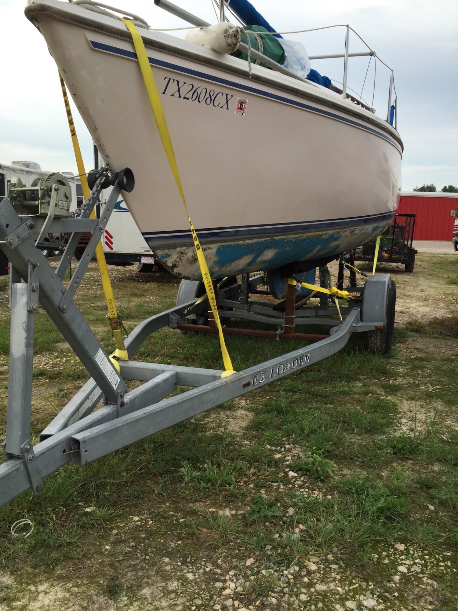

Catalina 350 35 Belton, TX
Yes, you absolutely need to lower the keel onto a support once you have the boat on the trailer. The keel is very heavy and will damage the lifting hardware if you keep it raised. As far as height goes, keep the rollers as low as possible but that will still allow you to lower the keel a few inches. The lower the boat rides, the easier it is to trailer, launch, and recover. Never allow the boat to rest on the keel— this could cause significant damage to the fiberglass keel trunk and hinge housing.
These are great boats, I had one for years, and are a blast to sail. Enjoy. 43A6DE20-F160-472D-AC5D-002A381B4D85.jpeg
These are great boats, I had one for years, and are a blast to sail. Enjoy. View attachment 168659
Thanks for getting back to me. Yes, keeping the keel trunk and hinge housing intact is of utmost importance.
