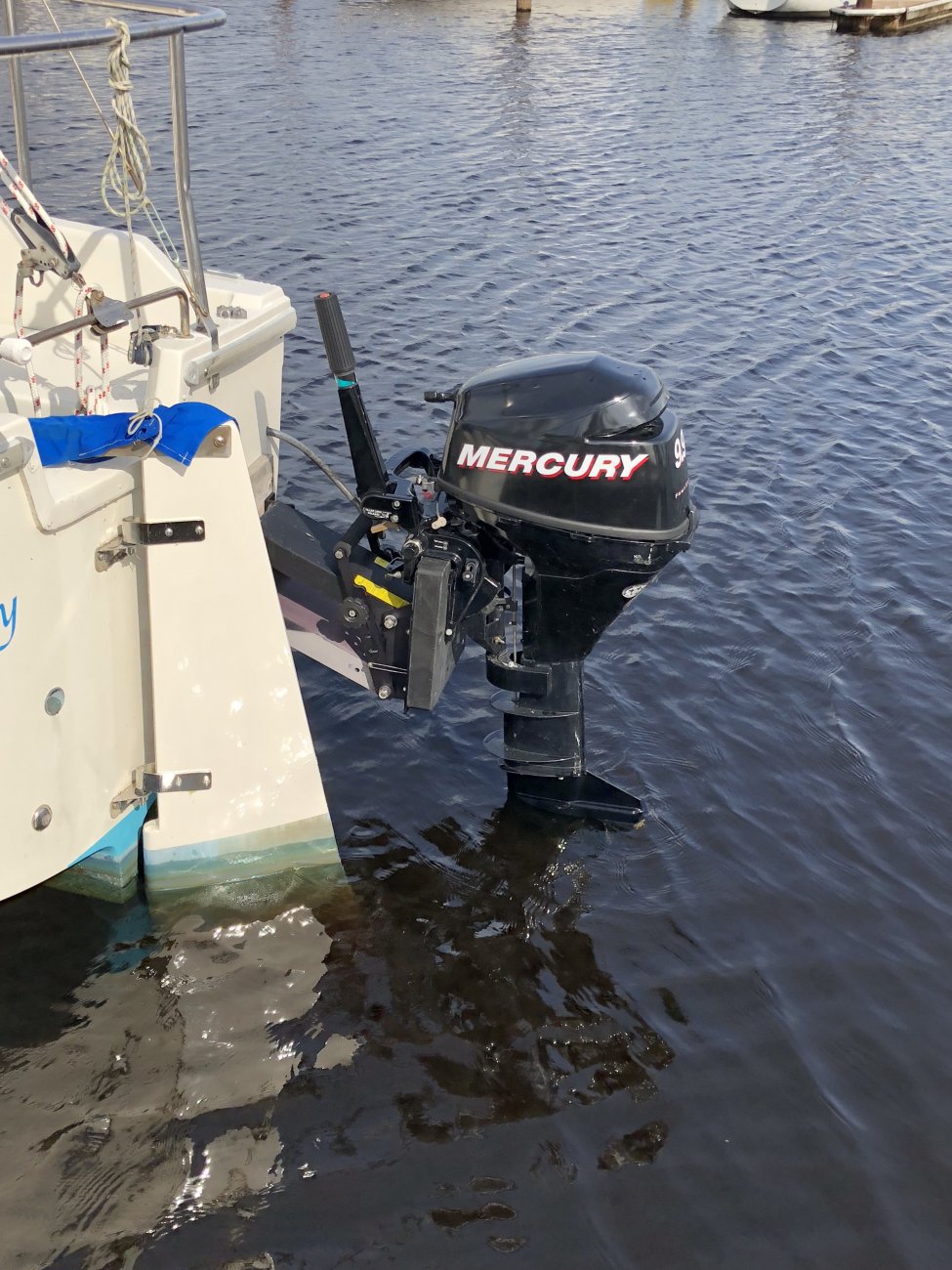

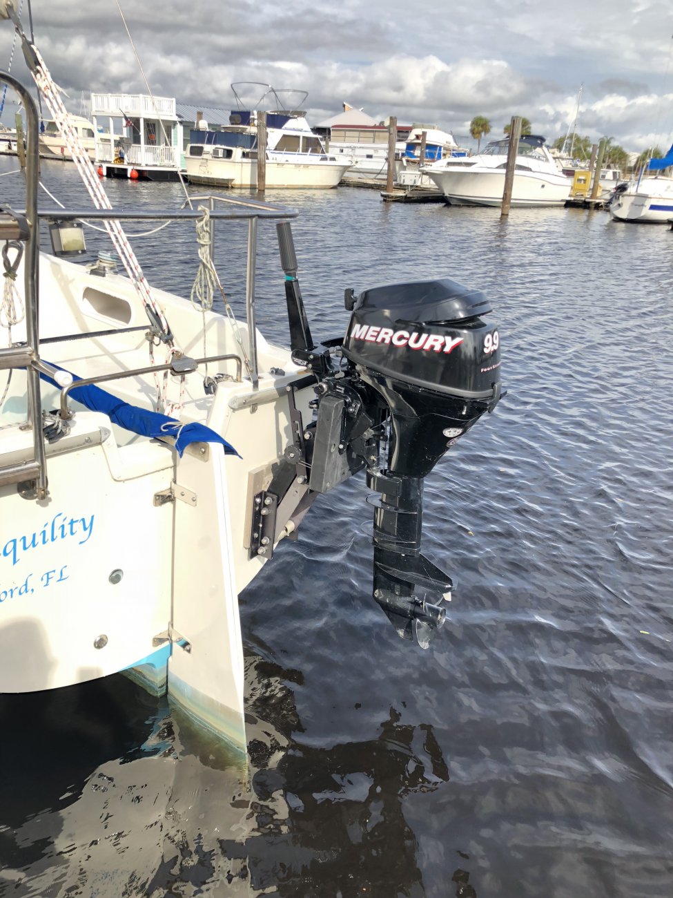

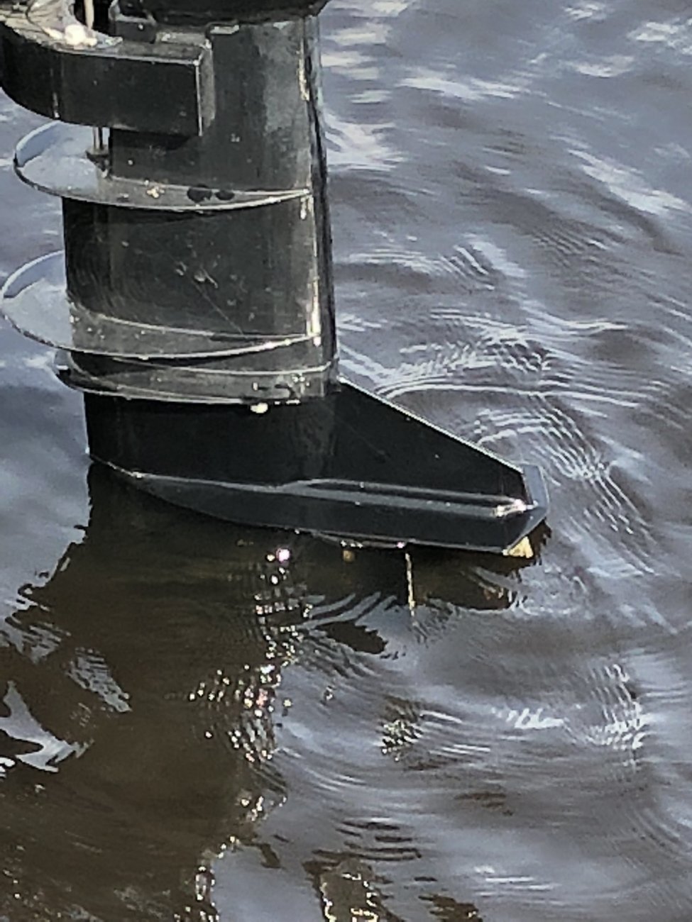

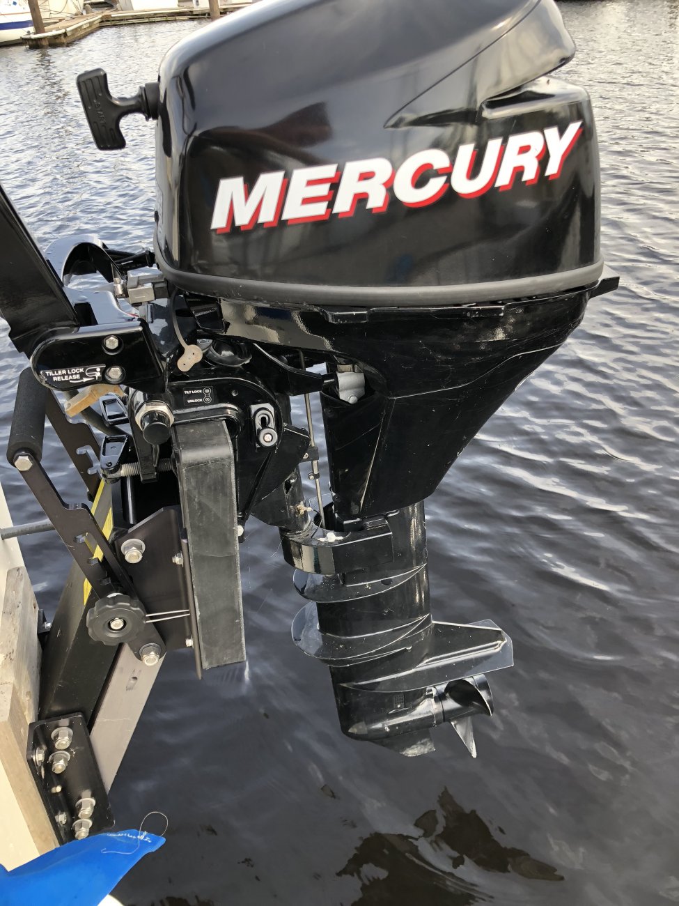

On the Catalina 25 I just purchased, when the engine is lowered the anti-ventilation plate is about a half inch above the water. It's a regular length shaft. I found some specs that recommended a long shaft.
It works in calm seas, even though it's a bit obnoxious, but it pops in and out of the water with even slight waves. I've thought about trying to remount it in a better place, but there doesn't seem to be one. I've heard I may be able to find a kit to convert it to a long shaft.
How have other Catalina 25 owners dealt with this? Do you have a long shaft? Or is it mounted in a place where this isn't a problem?

The water stains on the rudder and the keel stubb suggest the boat sat a couple of inches lower in the water than in the picture how much deeper in the water do you need?
Was the previous owner a couple of pounds heavier than you? Was the boat loaded with more gear? Stuff hung on the stern? This might be what is the difference as to the PO using the current motor and you needing a longer shaft.

That would make sense. Since I'm just a day cruiser, I only have a few tools and cleaning supplies, but I keep the boat bear bones empty. Every time I watch that show "Hoarders", I compulsively donate and recycle. Haha. :)
Also, the water tank is empty.
Just spitballing, how much weight do you think it would take to drop the boat 6"?

Lack of cooling water will overheat motor and wear the impeller faster.
Also if you get caught in swells and no wind you might end up on the rocks.

I have a Catalina 25 with a Mercury 9.9 Bigfoot 25" longshaft, mounted on the Catalina Direct motor mount. From the pictures it looks almost like the same engine and set-up as yours, except for shaft length.
I bet your ok for now as you lake sail.
For comparison, with the motor mount all the way up on my boat, my engine skeg and 1/2 of the propeller are still in the water. If I want the engine out all the way I have to tilt it.
I have ventilated the prop once this summer for a second in a big storm coming back under engine power to the marina, but the family was inside the cabin forward which shifted the weight forward somewhat.
I used to sail Charleston SC with another similar sized sailboat with standard shaft length, the prop ventilated all the time, not fun when the weather changes for the worse. Even worse when the current is strong.
