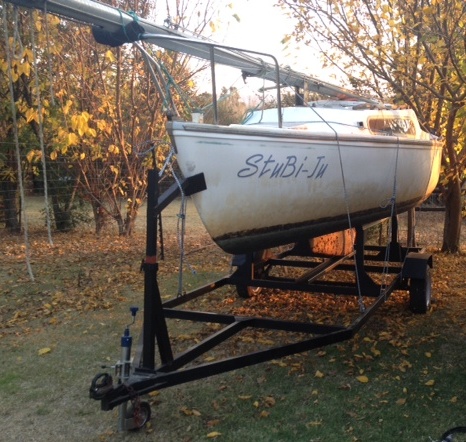

As you can guess I am new here . Briefly and by way of introduction my name is Theo and hail from South Africa ,I recently bought a 22 ft Catalina and I will need a bunch of advice and guidance going forward as I get into stripping her down and repairing damage ( nothing structural) mostly dings ,woodwork , paintwork topside and hull restoration

WOW! South Africa! Some photos would be GREAT,(we like looking at boats). Wonder how she got there? Is she possibly the Jaguar-22 version that was manufactured in England under license from Catalina Yachts?

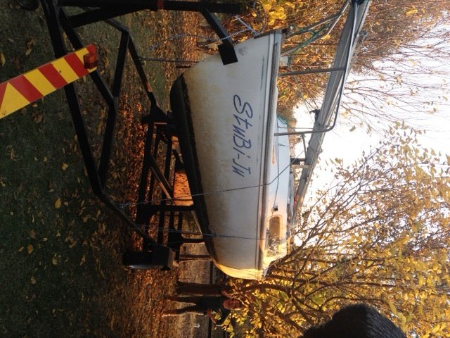

I will take some decent pics shortly and maybe we can identify her origin

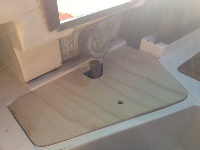

I have only just begun working on her , removing all wooden components topside and in the cabin and generally giving her a good clean and tidy up . Then I can access what's needs to be done One question can you identify the winch ?

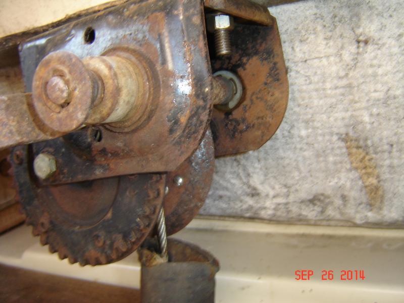

factory winch
That winch is not the standard one from the factory at least in the pre 86 series which yours seems to be. You can get replacement winches from catalina direct and other sources, Here is a picture or two of the factory model on my Cat 22.
