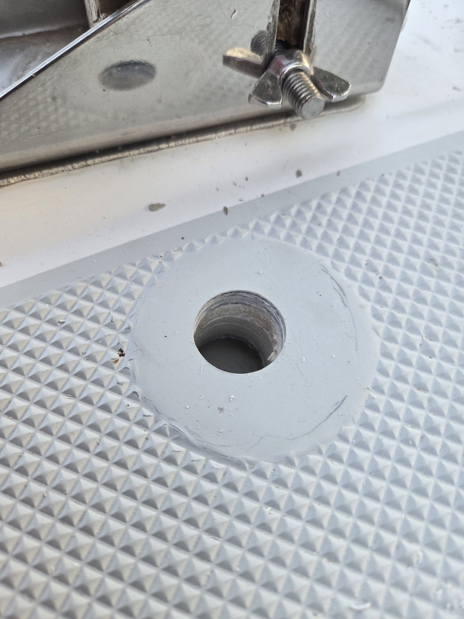

Hi in searching through online resources I was told there's a small dimple next to the mast if you drill down you can find the wiring for the mast that then hooks into the panel does anyone ever done this unfortunately I've already drilled down in there is a void but it is very shallow maybe a half inch
I do not see any wiring I do not want to drill any further. Anyone have any tips here? Thanks so much. Hope I didn't make a hole for nothing

It looks to me like you found a good place to drill through the deck so that the waterproof outlet can be installed but never was when the boat was manufactured. The next task in your journey is to find out if wire was actually prewired for mast lighting and how to get through the ceiling trim. On my boat a dome light was actually installed approximately in that position and so I removed that assembly in order to access the circuits that I wanted to run up the mast.

It looks to me like you found a good place to drill through the deck so that the waterproof outlet can be installed but never was when the boat was manufactured. The next task in your journey is to find out if wire was actually prewired for mast lighting.
Thanks I talked to Catalina direct tech they said this boat is too recent to have the wiring in the hull so yes I have a hole where I will need to get wire up from the cabin ceiling he says there might be a way to snake through the steel compression post under the mast just to hide it a bit. Some had holes for this purpose. Otherwise I'll find as neat away as possible to get the wiring to the ceiling and out through that hole.

Is there a channel in the cabin ceiling that runs from the location you drilled the hole to one of the sides of the cabin? I wonder if you can run some stiff wire through it and see if the void goes further. Then maybe you can run the wire off to the side and keep it more out of the way.

As a Catalina dealer years ago, the mast light wires exited the mast above the mast stem mast foot and plugged into.a deck socket in the area shown where is flat grey area with a 3/4 inch size hole. The wires then ran down the channel to the side.
First mistake was enlarging that hole to 1 inch. I used a snake with a string tied to it trying to run new wires

Thanks for the tips! Solved it. Actually, my hole is in the right place, and no, there is no wiring buried in the hull. Instead, in the cabin there is a plastic rectangular ceiling cover next to the mast compression post (maybe 6"x3"), which essentially creates an electrical box for any mast lighting, this box/cover lies on the cabin ceiling directly under the spot I drilled the hole by design (whew!), and wraps around the top of the compression post. There is a notch in the top of the compression post (in a 1996 c22 mk-2 this is a steel post) where wiring can be wired from a channel in the floor up inside the post to the ceiling (currently the overhead cabin light is wired this same path). To put new wire through, you need to unscrew and remove the compression post so you have access, so only can be done when mast is down. I also had to detach the cabin overhead light temporarily. Everything is ready, I'm waiting on some good marine grade wire to finish the job.
