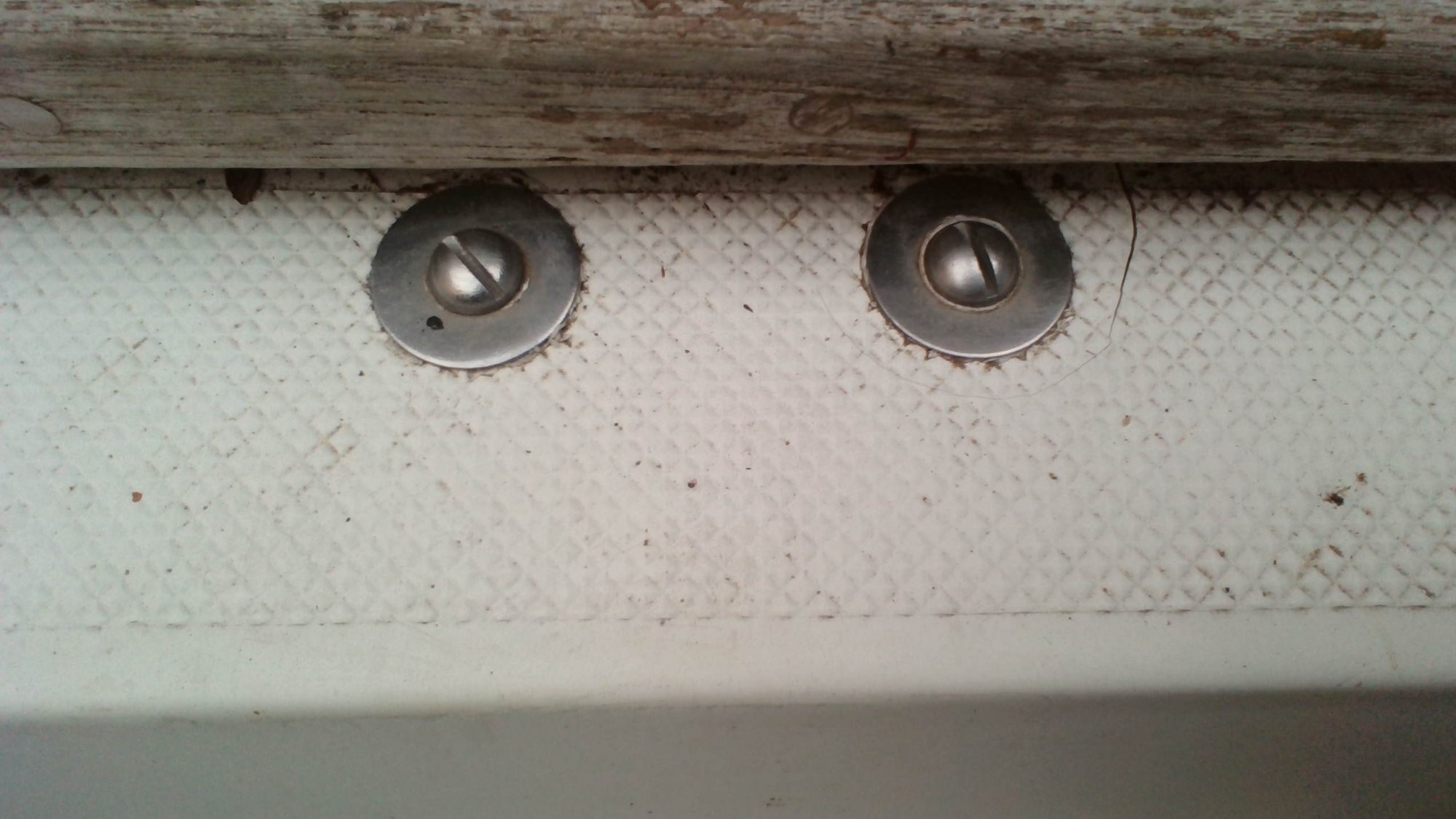

I recently bought a 1990s Catalina 22 that had been sitting in someone's yard for five years. It was very dirty when I got it, but it is still in good condition. The previous owner stored it correctly, so the rigging is in okay condition and the sails are usable. The only thing I am concerned about is these stress cracks around the keel winch bolts. What should I do? Should I just sail, or do I need to fix it? If I do need to fix it, how can I do it cheaply? I don't have much money to spend on this boat, and all I really want to do right now is get it sailing. Here is a picture of it for reference.

It doesn't look serious yet. I'd work on determining just how wet the wood core really is, and have a long term plan to deal with it eventually, if need be. It's not an expensive fix, but it's a messy one.
For now, I'd go sailing immediately! Enjoy those six weeks of sunshine! :biggrin:

If you find enough rot underneath to warrant doing something eventually, at least it's an easy area to access. I epoxied in a G10 plate to distribute the load and added a couple more bolts (and then never thought about it again). A picture or two down near the bottom of this post.

My advice would be to remove the bolts and see what's there. If for no other reason but to re- bed them. While they're out, counter sink the top of the holes a bit. This allows the bedding to squeeze around the fasteners and form a good seal there.
Let us know what you find and there will be plenty of advise on how to address it.
But, as Gene said, don't let it stop you from using the boat.... unless you witness movement under load.
