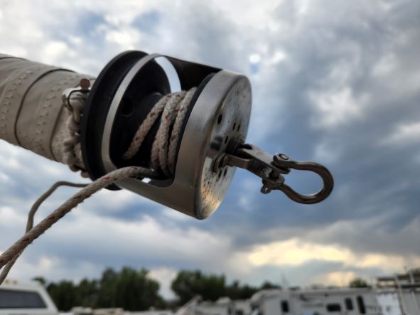

UPDATE: Got the boat out for the first time on Monday. Stepping the mast was not a big deal at all - it went right up and we were able to keep the mast up just having it lean forward until we could get the forestay attached. THAT was the hard part! We just couldn't get it pulled far enough forward to get it attached to the bow. We loosened the backstay as much as possible, still no good (1-2 inches short). Eventually I found a strong U-connector and attached it successfully - then we tightened the backstay again. We went around and did our best to tune the standing rigging all around and thought we did pretty well. However, when we were out on the water, we could see that under load, the backstay was too loose. I've got some ideas on how to make this process a bit easier, but always ready to hear additional advice.

The backstay has a turnbuckle that is adjustable, and it's adjusted as tight as it can go. This is a photo of the linkage under the roller furler on the forestay. You can see the extra U-link that I had to use just to get it attached. I'd like to loosen the backstay, take that U off, and see if I can get it attached as (I believe) it was before.

That's not bad.
The forestay length has a lot to do with the feel of the helm. So figure out the right length and keep it that way. If it is too short you'll be fighting a weather helm using too much rudder and slowing the boat down. If it's too long you'll have lee helm. The right length is often published by class associations or other sources. Adjust the backstay to fit.
