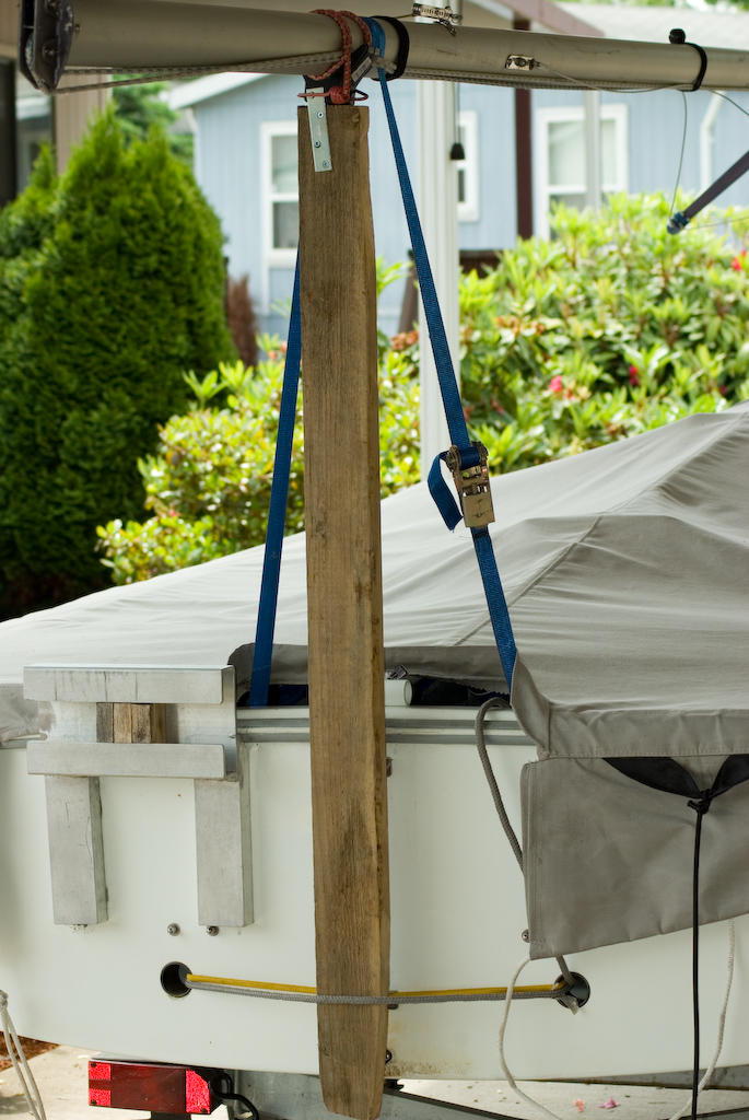

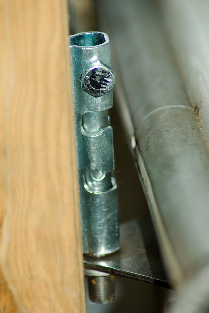

I had a canvas cover so I unhooked the shrouds and bungied them to the mast. I also made a support for the stern that used the rudder gudgeons and supported the aft end of the mast. As you can see from the photo below, there was a bungie holding the mast crutch down and a strap holding the mast to the boat. The rope going through the scuppers has a loop in each end for the hooks on the strap.

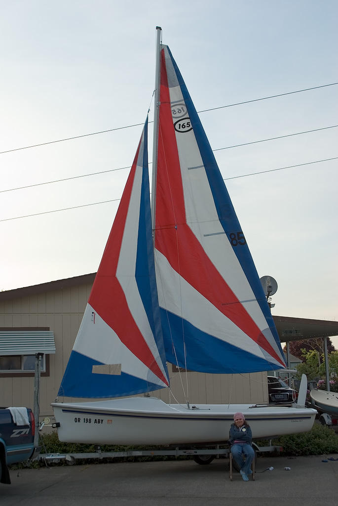

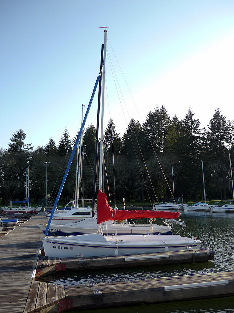

Note the fading on the jib in the first photo. If you're going to moor the boat then invest in a jib cover. My wife made a set of covers from a Sailrite kit.
