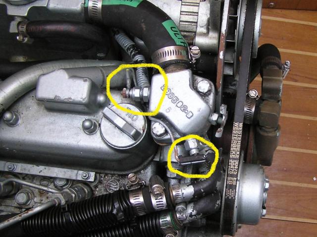

Assuming electrical connections are OK ...
Next things to check in order are raw water intake components (intake valve and hose up to raw water pump), water pump (front of engine, 3 bolts) and then heat exchanger. Finally if none of those then look at your exhaust elbow.
PaulJ, Wouldn't the short just make the gauge read zero? I recall mine fell off once and I got an alarm and a weird reading, but don't remember the specifics.

The thermal couple's (sending unit that is mounted on the engine) resistance is inversely proportional to the temperature, thus as the temp. increases the resistance goes down. When R goes down I (current increases) causing the needle in the gauge to deflect more. It is acting like a current meter. So, Paul is correct if it is shorted the needle will read max. and may eventually burn out the coil in the meter if the circuit is not designed correctly.
