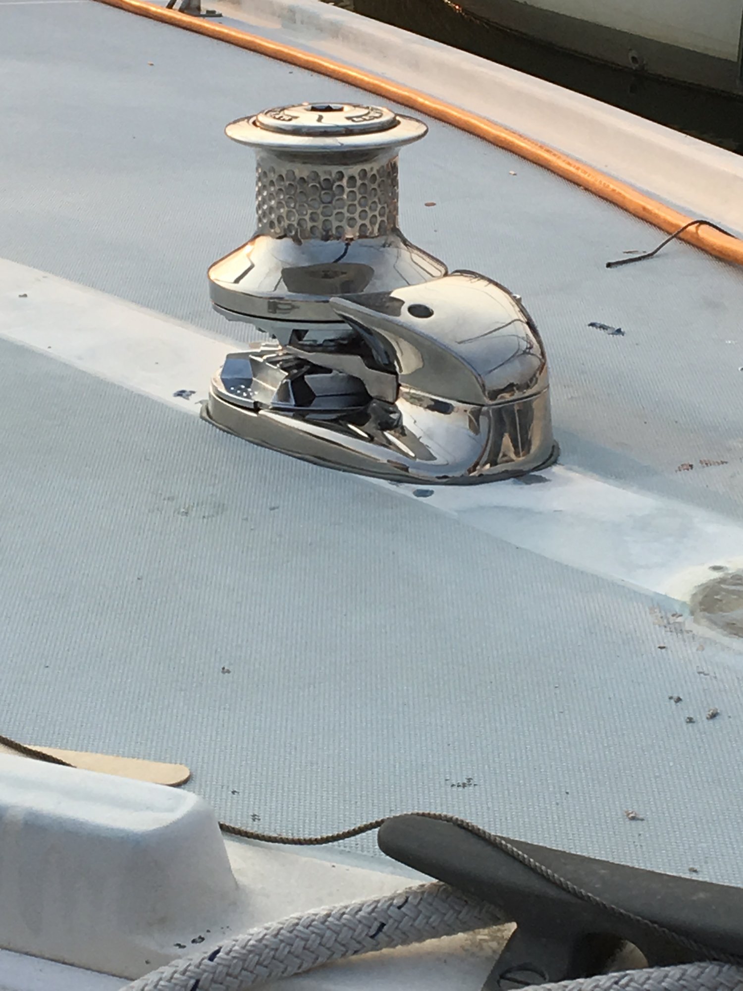

Here is an image of my windlass. I too wanted to make my life easier, where no windlass had been before.

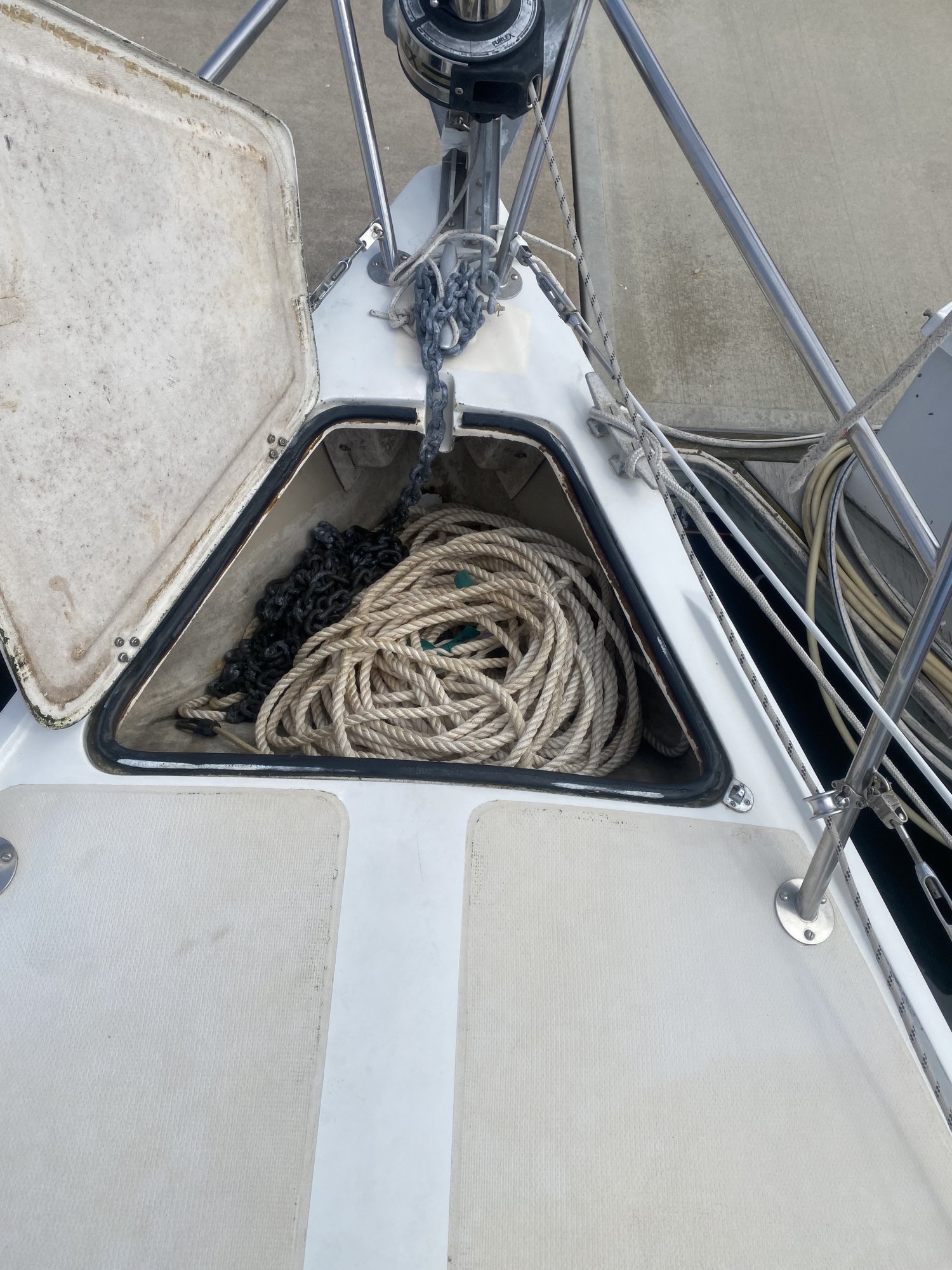

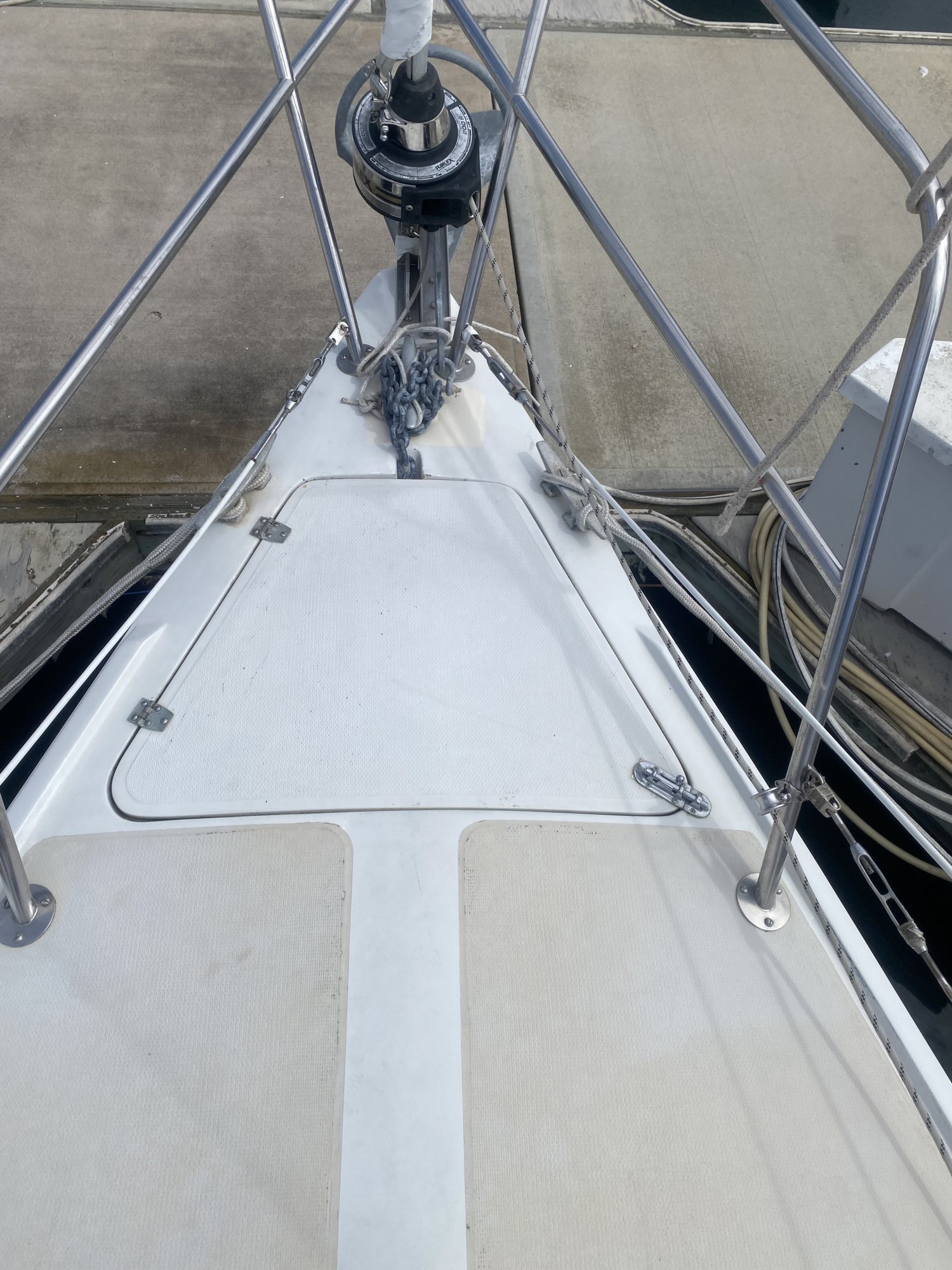

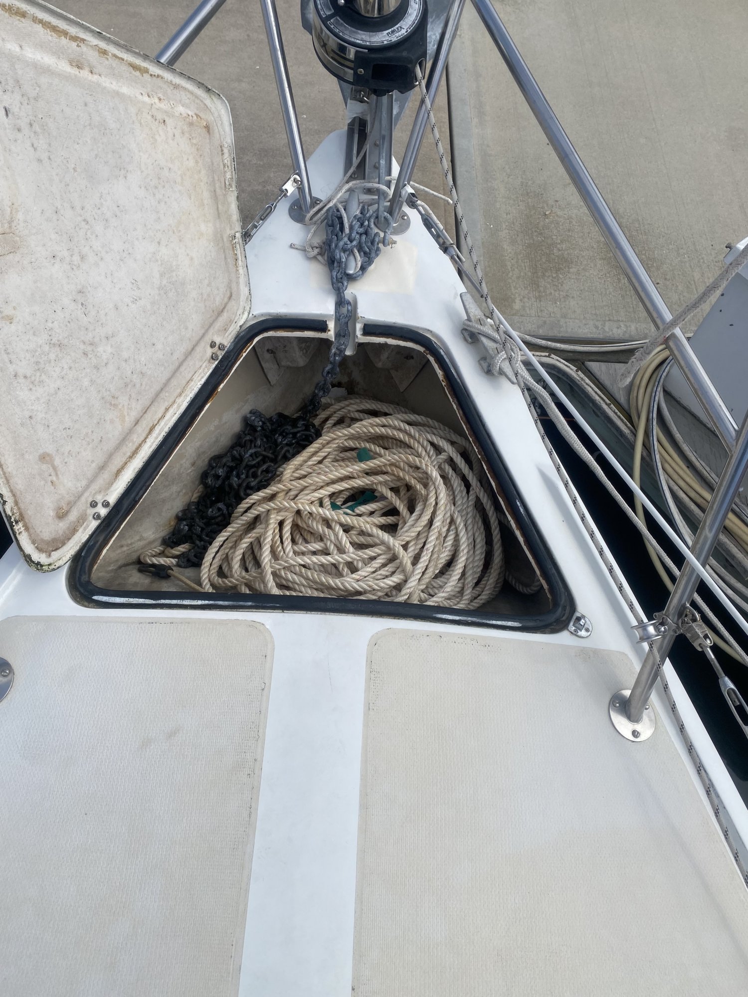

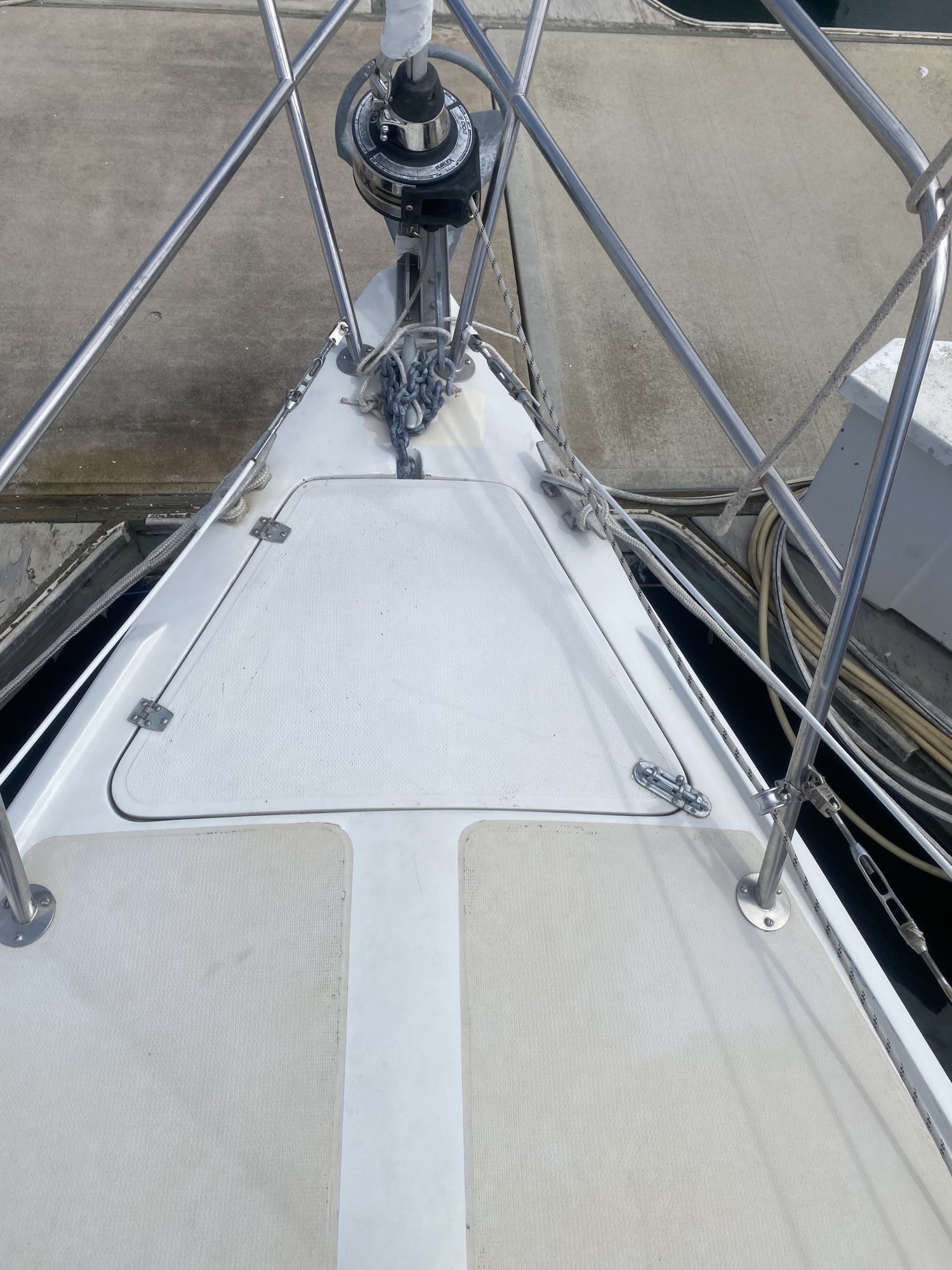

Hi all:
Thank you for all your quick responses. As advised here is the anchor locker both open and closed. I am also searching for other C30 boats in the marina with one installed, still on that search.
Pete
  • Helpful
Likes: Ward H
Jan 4, 2006
7,806
Aw crap, looks like the same old problem of limited room in which to mount a vertical windlass. If you search the archives, you will find several articles by people who have successfully mounted sturdy windlass platforms within lockers similar to yours. See if you can find several of those and we can go from there.
