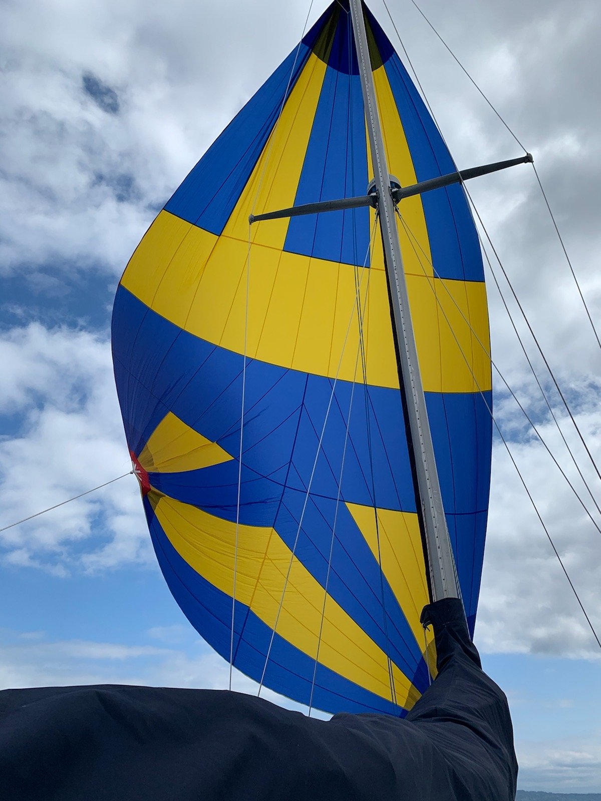

1) Low wind conditions are better serves by an asymmetrical spinnaker than a 150% Genoa.
2) A 135 jib on a furler in condition 2 (solo) or social cruising is easier to manage in all conditions but especially if the conditions change for the worse. Smaller sails are easier to manage. In a social environment a colored spinnaker with low wind is a beautiful experience and will leave a lasting impression on guests.
3) The foam luff is not about ease of reefing it is about trying to improve the sail shape. Note the word trying. A reefed sail has poorer performance. Which is the intent of reefing.
For all of your conditions, I would recommend the 135 Jib and a asymmetrical spinnaker. You can put it on a Top Down furler and have the best possible arrangement. I solo sail and use my Asymmetrical, deploying with a sock. I fly it in less than 8 knots of breeze and it looks exceptional. It can be flown with or without the main. Here is the sail flying. We are in an 8 knot breeze, doing 4.5 knots on a beam reach.
