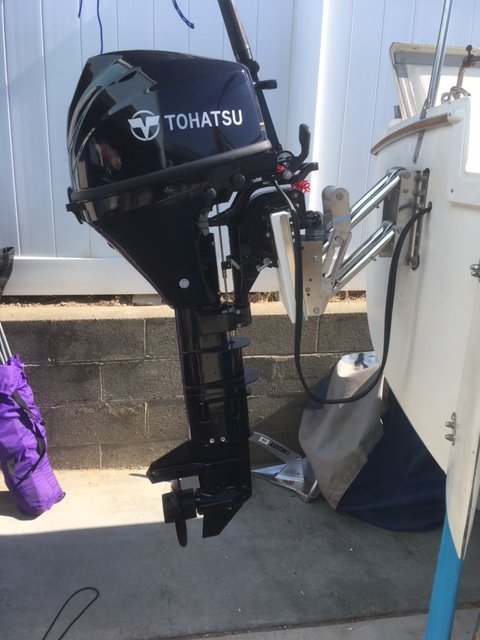

I just did the upgrade from 6 hp to. 9.8 with 25" shaft Tohatsu on my Catalina 22. I wanted electric start and the altenator I love it. There are some weight and balance issues to address. I had to add 75 pounds of weight to the front of the trailer to get the toungue weight to 10%of the total trailer wieght. This was needed since I leave the motor on now and do not remove it for trailering. I also added two batteries up in the small storage area under the v-birth to balnce the boat on the water. I used the motor mount from Catalina Direct with three springs. The balance is perfect with the weight of the motor. An important part of the motor mount was I had to move it higher up the CD recommends in the drawing that came with the mount. I first followed the drawings and on the sea trial the motor head and mounting plate were way down in the water when under power, I had to run it with the motor not all the way down until I fixed it. I moved it up 4.5 inches and it is now perfect. I also used a 1/2" piece of plywood to make a backing plate for the motor to help support while trailering. If your interested in more info shoot me a pm and I can send pictures or answer questions. IMG_0020.JPG
