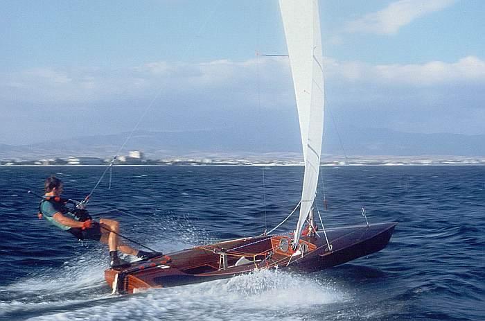

In dinghy sailing weight aft equals serious drag from the transom wave turbulence. We always tried to keep the transom out of the water and have the water break away from the hull clean rather than that backwash that builds up and causes drag. I can assume that would be the same for any size boat with a near vertical transom...
Seems like for all it's vast cavernous space below decks for storage not much of it is useful for fuel storage. Why not use gas tight containers and store them aft inboard under the cockpit sole where weight would be great?
