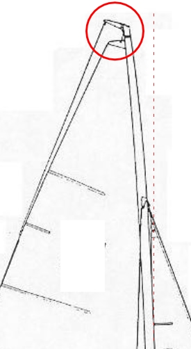

There is a middle ground (but check your intended class rules) in that a 'log' type aluminum mast 'can' be tapered, or you can seek an already tapered Al mast, wherin a 'v' is cut from the section through most of the mast top and about 1/3rd the way down on both sides the mast then rewelded ... and a 'moment bending bar' is added to the head - essentially a horizontal 'bar' at the top that extends well aft and the (full adjust) backstay is connected to the aft end of the 'bar'.
Tapering is a 'halfway' and the CF masts through better evolution/knowledge have most entirely replaced the tapered Al masts ..... and those boats that didnt change now sail essentially 'obsolete' class boats. So too, such boats should have extreme 'light weight' and 'precise' laminate sails to 'match' the lightweight spars and matched to the skill of the helmsman. Were talking serious $$$$ here.
