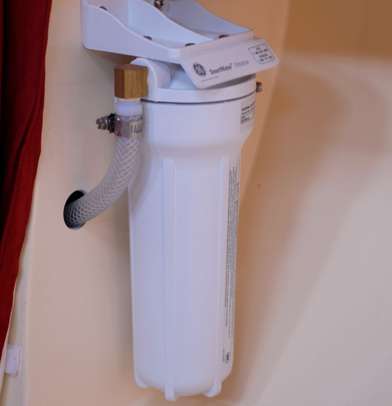

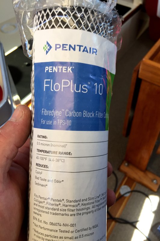

#1 Our tanks are fulley cleaned and the system 100% shock sanitized each srping.
#2 Our tanks NEVER have antifreeze in them.
#3 Our water is pre-filtered before it goes in the tank.
#4 The water is treated in the tank.
#5 We use this filter housing on the supply side of the pump;
#6 We use this filter in the housing:
#7 We additionally filter with a Brita on-faucet filter.
#8 We send the water out for testing at least once per season. It has always tested as 100% safe & drinkable..
Nov 8, 2007
1,578
We have followed Peggie's instructions for 18 summers on Lake Erie, using water from municipal supplies through Marina systems with never a problem. Buy here book on this site, its a real bargain of value over cost!
