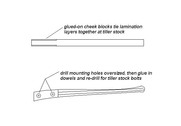

My common rescue for tired split laminated tillers is to first open all splits up and re-glue them. I use Franklin Tite-Bond II glue for this. Only medium clamping pressure is needed; I often just use clear packing tape, wrapped as tight as possible for a clamp along the split(s).
After the laminations are glued up. I go two steps further. The weak link in a laminated tiller is at the tiller stock, where the tiller is attached to the rudder. Most of the weakness is due to the cross drilling. I start out by going to the table saw, and with a fixture, I mill away about 1/4 inch of material on either sides of the tiller, for a distance of about 6-8 inches. The length is not critical. I then glue on solid wood material equal or slightly greater than the material thickness removed. I refer to these as glued-on cheek blocks in my image below.
After the cheeck blocks are fastened, sanded and faired to the rest of the old tiller, I mark and drill for the thru-bolts. Then I OVERDRILL the holes. Using a hardwood, teak or mahogany dowel, (I usually make my own using a die that was cut with the same drill bit I drilled the tiller with) I glue in two lengths of the dowel in the oversized bolt holes. At this point, I have modified the attachment end such that the laminations are tied together by the cheek block on the two sides, and the cheeks and laminations are tied together by the cross-dowels. This is procedure that is time intensive, but well worth it, as the result is a tiller that is much stronger at the typically weak mounting location.

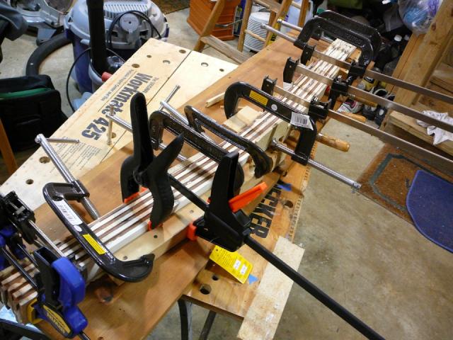

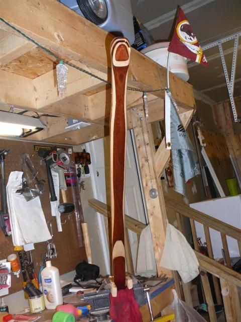

I've built several tillers...after you know what width you need (between the tangs on the tiller head, might as well measure the old one if it is correct) rip that width and then laminate alternate light & dark wood colors...I ripped mine to 1/4" thick on a table saw. After I had 7 or 8 pieces of wood, I soaked mine in the bathub to soften it and then laid around a form (some blocks of wood screwed to an old shelf board) for curvature. You could lay the old tiller on the shelf and then screw blocks down at the pressure points to simulate the old tiller, or design you own shape. I have used Gorilla Glue on my last two tillers since it uses water as a catalyst. I used maple & mahogany since that is what I had, but most are mahogany & ash I think. The maple is a little tough to sand. After you have a 2" square chunk of cured laminate, the shaping by hand is the tedious and fun part. I've used a chisel, belt sander, orbital, etc.
Sand to 220, and apply spar urethane, lightly sanding with 220 & tack cloth in between coats. Great winter project..I built one on the front porch of my old townhouse with a Workmate as a bench, or in the garage, etc..

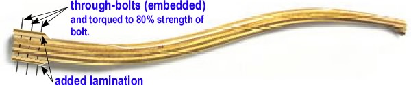

The easiest way to strengthen is to make the laminations in the area of the break THICKER, or add MORE laminations in the zone of the break.
Typically the laminations in a tiller are laid up 'horizontal'. Assuming that your intent to apply 'vertical' lamination in the 'tiller head end', ... could be a problem in weakening the horizontal laminations. Such tiller-head failures usually are because ONE lamination interface/face breaks, then the next, then the next .... so you might ALSO want to through-bolt the laminations (other than the very top /bottom laminations and only in close proximity to the tiller head) to strengthen the 'shear strength' of the laminations ... as well as add a few laminations where the tiller fits into the tiller head fitting.

Attached is a sketch/illustration of through-bolt 'shear strengtheners' and added laminations.
