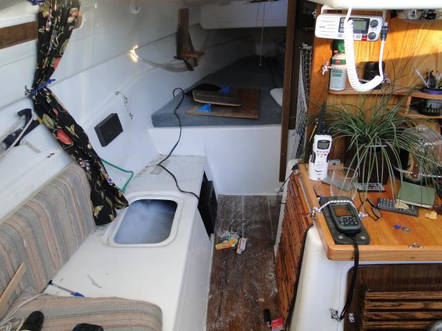

I recently added some front bookshelf speakers to the car stereo system in the boat (stereo is about $150 Pioneer model with external and Ipod inputs) so now there are four bookshelf speakers. I have a linklite battery monitor so can see how much current is being used. The current will vary all over the place as music is playing so you have to interpret a little but if I'm inside the cabin playing the music moderately loud, I'm probably using on average 1.5 amps. With the companion way open, this is loud enough to easily hear in the cockpit while sailing and even annoy other boaters who like things more on the quiet side. At very loud - starting to go into distortion (and too loud to listen to for long), the current might be between 2 and 3 amps. I have an Ipod on this and a classical song came up and between quiet and loud passages, the current varied from .7 amps to 2 amp. I would say an average current for my overall use might be about 1.5 amps, maybe a little less. Not really all that bad.

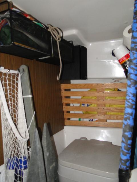

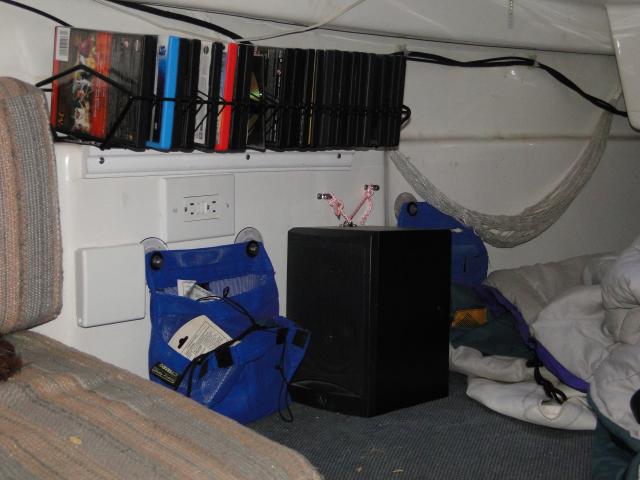

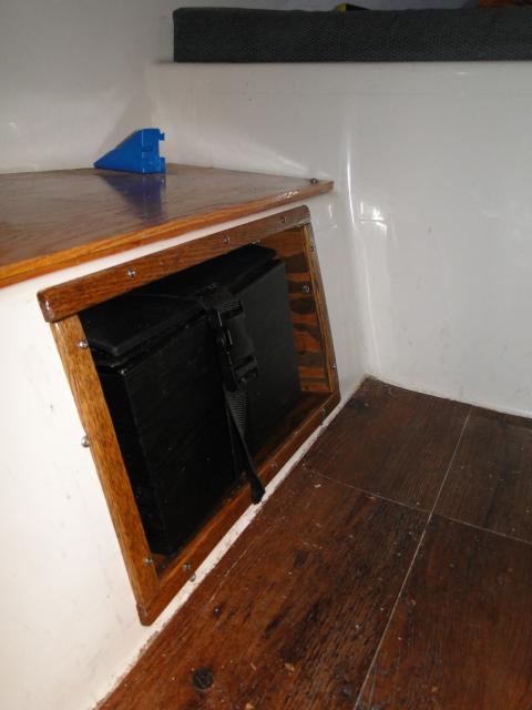

One sort of interesting thing.. I just mounted the new front speakers (Polk Audio). I auditioned these in the store and mounted one in the head area and the second up in the V berth area. In the second picture, you can see a wood shelf on the port side V berth area which is not used. All the bare plastic causes some odd acoustics and with this speaker up there, it sounded like I had an echo and also a resonance in the 1K to 5K range. So I moved this speaker to the spot under the forward port settee (had to cut a hole). One of the nice things about book shelf speakers is that you can easily move them around to see if you like the placement. I even had to rotate this speaker so that its pointing "up" before I wasn't getting the resonance. I'm happy with it now, the system has a nicely filled in and even spectrum.
