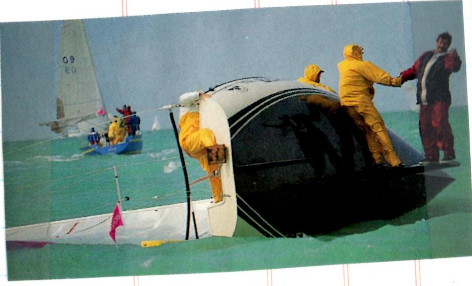

Ron 20324:
Interesting picture. But the boat in the picture is not a ballasted keel boat like the C-22. Its an unballasted racing boat. They easily capsize when knocked down, if the sail gets in the water and the crew is not quick to get on the center/dagger board. (As this crew is doing.)
