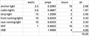

What are you using the battery for? Can you add up the amps that each device draws and how long you expect to use each of them?

Here's my work, I believe I calculated everything correctly at 12v? Worst case usage, USB assumes charging a phone and iPad once or twice a day. Replacing the front running lights with LED might not be easy, but I think I can replace the rear bulb pretty easily.

Group 24 batteries are usually around 70ah, you could easily run 2 days without recharging if you start with a fully recharged battery. For you purposes, an inexpensive LA battery would be fine. Going with LFP won't offer much except more expense.
The big issue with any battery is properly recharging it.

Your VHF will draw significantly less because it's transmitting maybe 1% of the time. It doesn't take much power when you're receiving. Product specs usually list the maximum draw for a few seconds, not the average. Think of how long batteries last in a portable radio.
